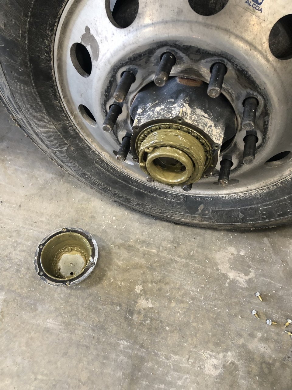

    Is that peanut butter on your bearings?
  5. beastr123
    beastr123 Road Train Member
    2,961
    24,308
    Jan 2, 2014
    Moose Jaw SK CAN
    Water in the grease
  6. shooter19802003
    5,654
    42,113
    Feb 8, 2010
    Condensation?
    Tug Toy Thanks this.

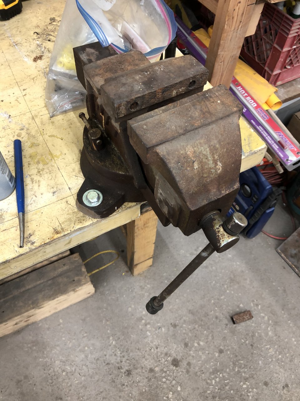

    Good deal. Don’t know if you’ve seen the price of a good vice lately. Outrageous. Glad I bought mine 25 yrs ago.
