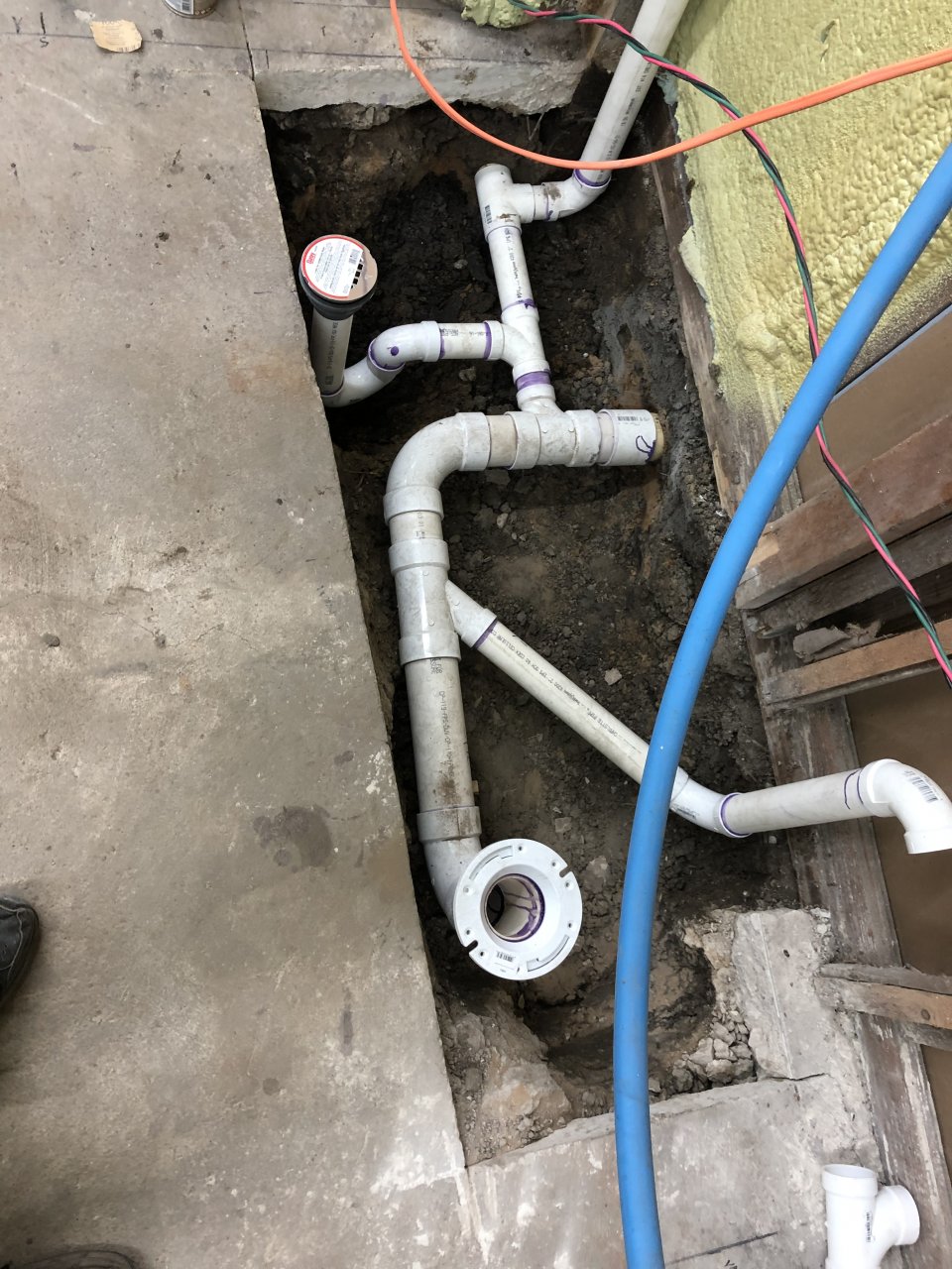

    Got some plumbing work done today at the shop. 38BC5AE2-1B58-4668-8F61-B2EAA1BAA357.jpeg

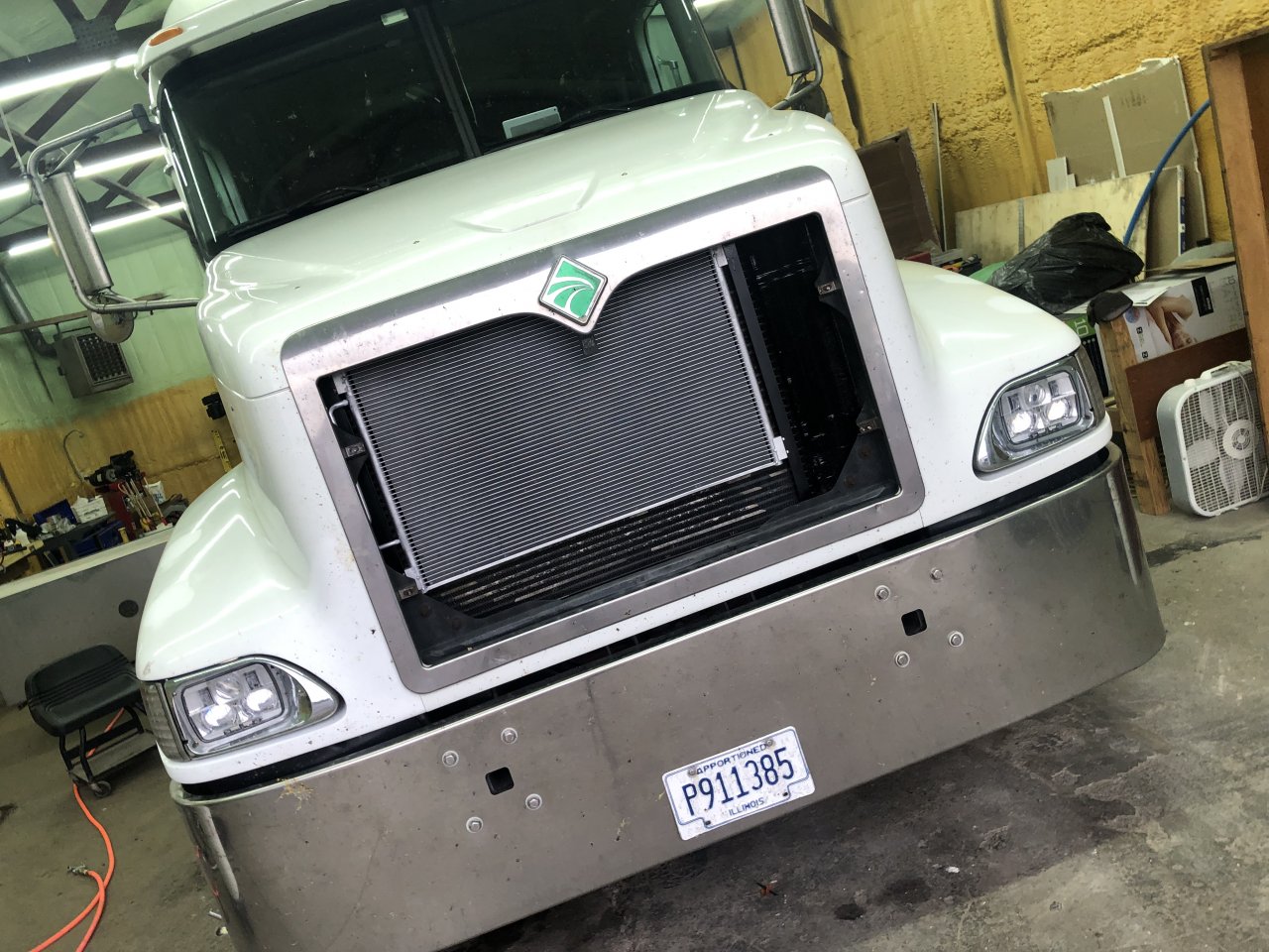

    Saw this yesterday and thought of you. Keeping those old Internationals looking good.
