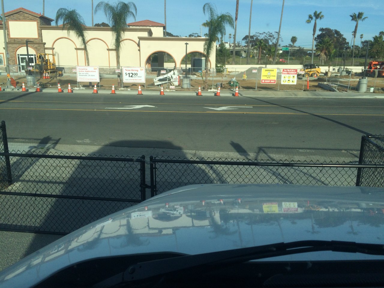

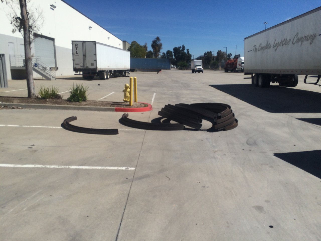

    So, I scrambled to the yard in Illinois to pick up my new coustemers load. It was only a partial so I had them get something to go with it. They loaded it on another trailer. Well the first one was 15k lbs and the second was a ftl that was to be 33k lbs. guess what? Turned out to be 35k lbs plus. So can't scale with the KW 680. Load has to arive wendsday morning. Looks like I have to drive my truck. they loaded the 15k on the back and the 35k on the front. Spread open on a 53'. 34.5 on the trailer. image.jpg After a long conversation with the guy I'm leased to im going to go for it knowing I would be over on the trailer when I closed the spread in California. Hit California Tuesday night in my old international. Hid out in Barstow until 2am knowing I had to be in Escondido at 8 am but they have parking. Down the hill...... El Cajon closed...... Rainbow Open. 2300 over on trailer. Untarp load and move 23 96 lb sheets from the back to the front. 2 hours later and a weight ticket later on the road again. Made my appointment and unloaded new coustemer. Head to the border to unload second before noon. I arive and they say good we are going to check it here then you will need to take it a cross the border for delivery. Ah no!!! Ok drop your trailer and we will get someone to take it for you. Ah no!!!! Call broker and going to unload here. They only have little wherhouses forklift and no chains. Take the chain off..... 1 stack falls off the truck.... image.jpg
    These things are like 200lbs a piece. Had to restack myself as to avoid a damage claim. Moved Up to a private lot in Oceanside California to park for the night image.jpg
    In the morning I realize I'm sore as a mo fo and sun burnt from standing in the deck for 3 hours helping them unload. Up to Orange the next morning for granite slabs to Denver. Delivered this morning. image.jpg Beat feet to grand island Nebraska for my 34 and a pickup on Monday headded to the house for the rest of the week off. Well kind of, I have a long list of things to work on before I head back out.

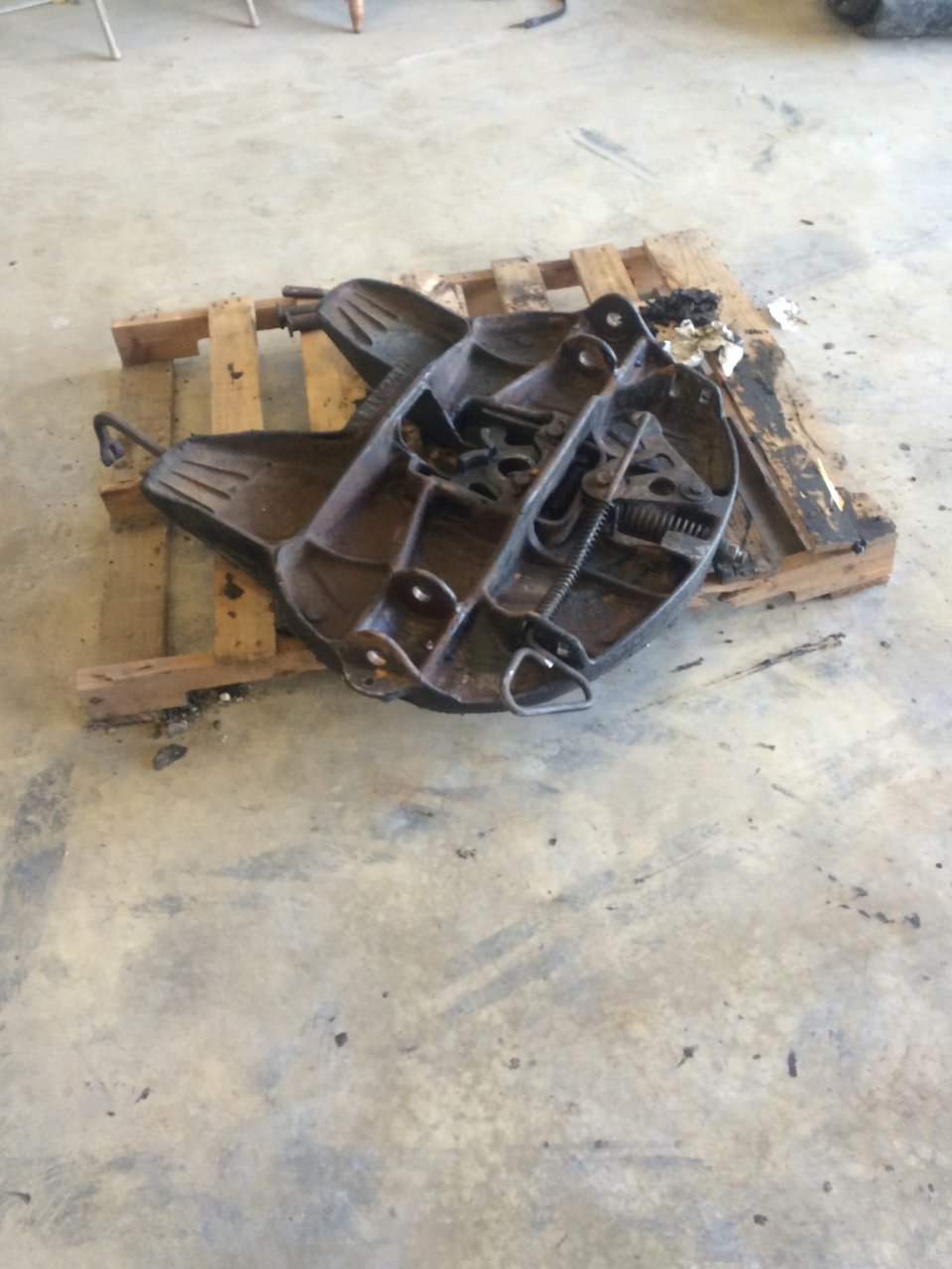

    Wendsday Worked on a few issues with the truck I had made a list for. Rear pinion seal leak, bearing on the accessory drive somewhere sloppy 5th wheel and fix the ac.
    Pulled the 5tg wheel off and flipped it over, presure wash and adjust. Works good now. Had so much old grease it would not let the yolk slide forward to tighten the jaws. Replaced the 5th wheel bushings and pins. image.jpg image.jpg Replaced rear pinion seal and inspected the u joints all good. Fill with oil.
