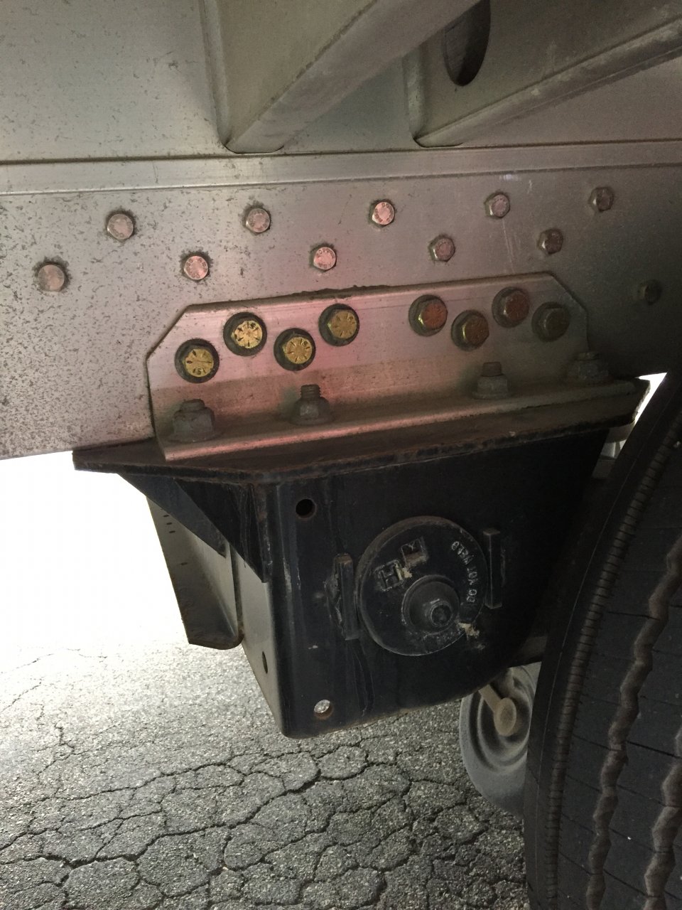

    Are these the junk brackets? I just picked this 2017 up this morning.

    Does anyone have pics of the problem brackets? I was told to check the bolts for tightness after I put the trailer on the road... 2016 Bigger Bubba

    Right there in your picture. The aluminum L brackets. If the bolts work lose they enlarge the holes. Then you drill them oversize and keep them tight. Looks like both of you already have the larger bolts.

    Call Reitnour and get the brackets before your brackets break. I would get the brackets in hand and then go to the dealer.

    those brackets are not the upgraded version. they are the same as mine and my friends. my friends trailer is 3 years old, so it may take some time before they crack.
