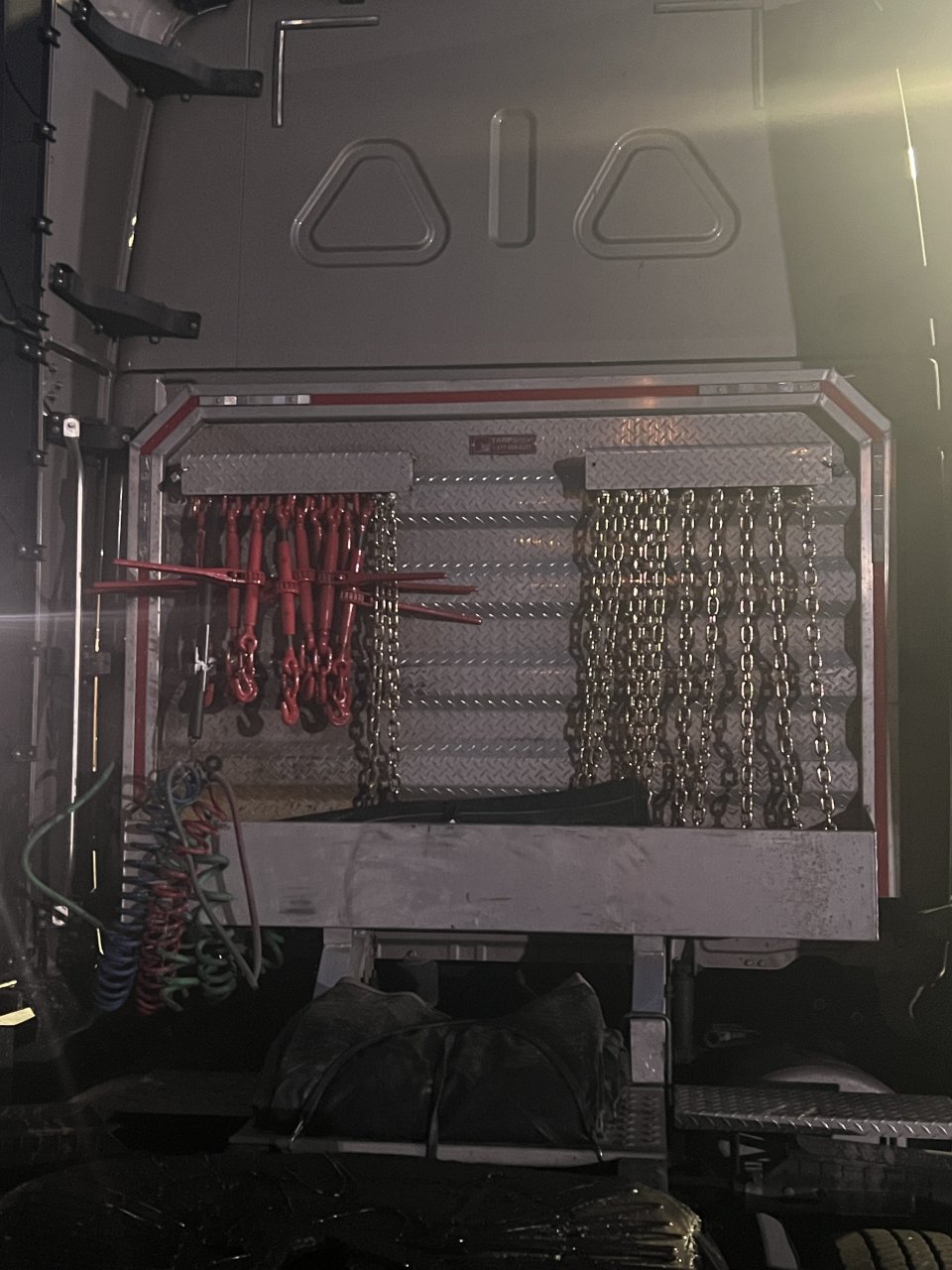

    Hey guys I just wanted to give you an update, I bought headache rack and all those flatbed equipments(chains,binders,straps…).
    Shoutout to @pavrom he sold me nice headache rack for good price. Here is the equipments that I bought;
    12 chains 3/8
    12 binders
    30 straps 4” and 2”
    10 Coil racks
    10 coil pads
    10 4”x4”x4’ beveled lumber
    1 Winch bar
    2 box bungee strap 21” 31”
    10 moving blankets
    2 packs edge protectors
    Oversize load banner and flags
    only thing is; trailer that I rented doesn’t have ramps for now but they will install it soon, idk if it’s gonna be problem at first place but let’s see how it goes. I put 2 padlock on it to protect chains and binders from thieves. What do you think?
    I’m gonna attach a pic, this is how my setup looks like.
    thank y’all.

    If thievery is a concern dont leave the straps on the winches when not in use. They will last longer too when safely tucked away in a box instead of exposed to the weather.

    You’ll want to secure the bottom hooks on those binders or they will unscrew and disappear while you are driving.
    Also, I would suggest keeping a spare winch bar somewhere on your truck in case you lose the other one. It will happen sooner or later I promise. LOL

    A tip to save you some headaches.
    Put half your chains and half the binders on each side. Take a chain and hang it from the bottom hooks on your binders with about 10 links between each hook. That way your binders won't unscrew going down the road. If you don't keep the bottom hooks from spinning they will fall out.

    This too. Don't ever set the bar completely on the trailer. Always lean it against the side or leave part of it hanging off the side when you set it down. That way you can look in your mirrors and see it sticking out if you forget it.

    Put some rubber behind the chains in that headache rack also, other wise all your gonna hear is chains bouncing off aluminum when stopping and accelerating

    when you try to unscrew the hook at the last point it won’t part apart, not coming off
