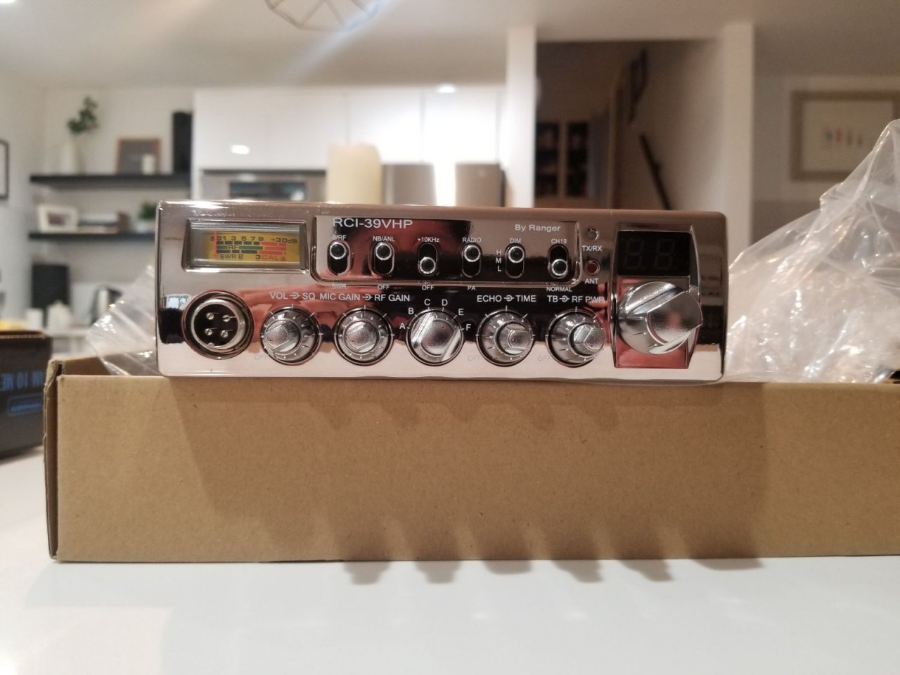

    So i got home on Saturday morning and had a late Christmas present waiting for me from my 3 daughters. A new radio from Lesters Customs. They had ordered it in September and it just arrived this week. All tuned up and expanded frequencies. Now i aint no radio boffin or anything but id like some advise on the install etc. Its going in a W900B. Should i put it in the factory cb pullout drawer, just a bit concerned incase this puts out more heat at the rear, and use the power cord thats already installed or run new wires directly to the battery. Also coax, just use the existing coax and the 2 firesticks on the mirrors or change it out to all new stuff. At the moment everything is stock gear from the factory. Just trying to get a good sounding rig going on, not trying to talk to the moon and back Resized_20190211_175918_4445.jpg Resized_20190211_175841_5015.jpg

    Nice gift. I never install a 10/11 meter radio in the cubby holes. all my trucks are mounted below so heat can escape with no issues of overheating the radio.
    rabbiporkchop, shogun and krupa530 Thank this.
  4. 43mack
    43mack Bobtail Member
    18
    4
    Apr 20, 2014
    Probably needs to breath putting out near 100 watts pep.
    krupa530 Thanks this.

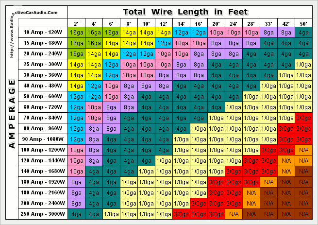

    @Slowmover1 , School me on the custom power leads please. What gauge wire and fuses etc. Radio came with a 3 pin plug to go in the back of the radio with 16g wire.

    How long will the leads be? End to end (and taking into account turns, etc that may need a bit more)
    From that point it’s a matter of determining amp carrying capacity versus voltage drop.
    If the radio will be in or on the overhead, thence to the batteries it’s a VERY long run. Meaning thicker and thicker cable.
    If there is a heavy lead from the battery to a circuit box above floor level, this will make things easier. MUCH easier.
    After measurements find an online calculator that determines voltage drop x length for given wire gauge size.
    You’ll need amp draw per X-Watts.
    See www.k0bg.com for this subject and more.

    Here's a chart to help figure it out.
