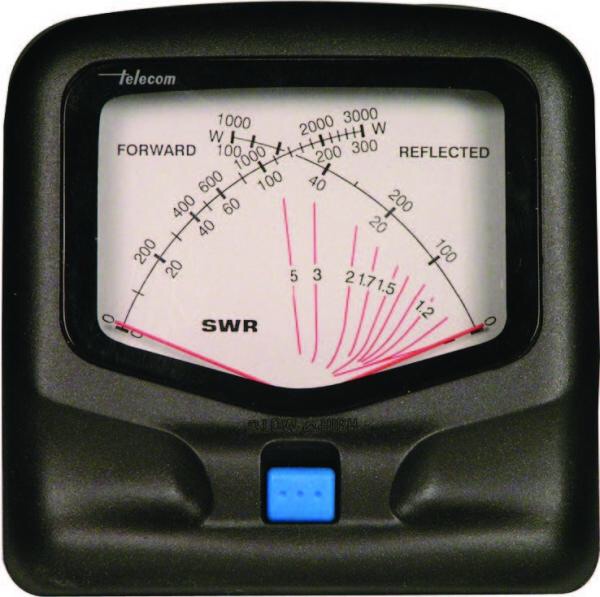

    I shouldn't be so down on RadioShack, the meter was cheap, and did its job for 10-15yrs but like your link states I have no clue how accurate it was. But it was clearly bad before I had my way with it.
    Bought this one below off a friend for $10, receipt inside the box was for $40 original purchase price.
    Any thoughts on its accuracy?

    I got tired of cheap meters so now I carry this with me.
    TheDude1969 Thanks this.
