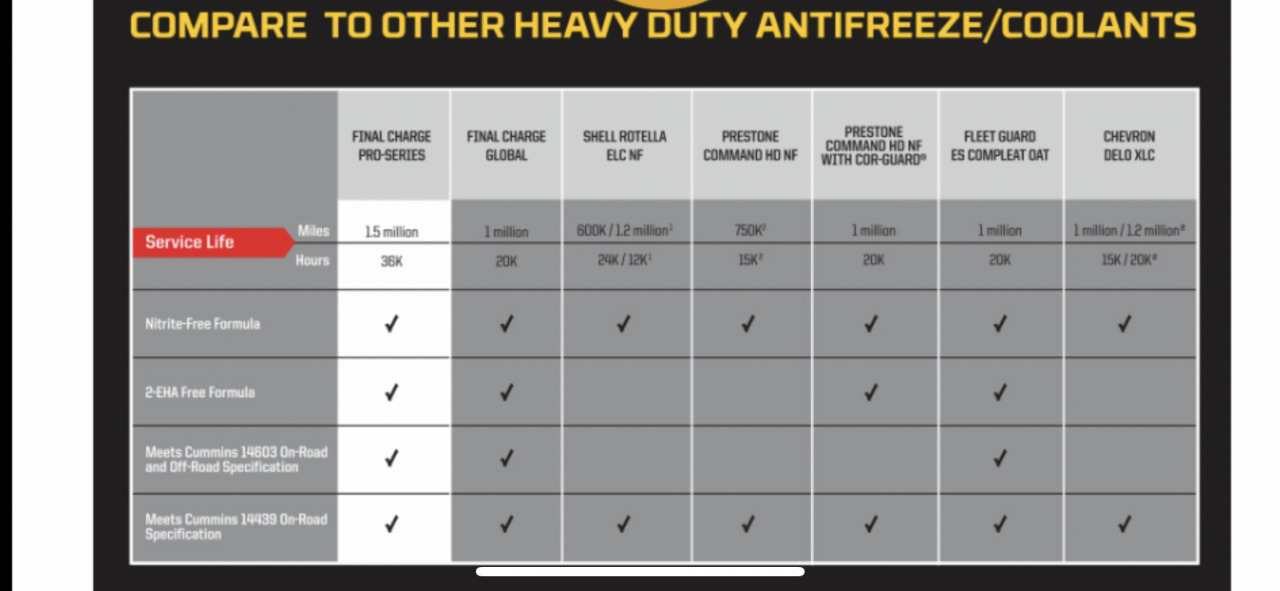

    993AB21B-DDFF-47F8-9D9B-C83ED92263A2.png Nitrate free. Pick your poison. It’s expensive. The Peak Final Charge Global is available in Concerntrate. I’ve found it online, possibly special order at Napa. Mixed w/ distilled water at 50/50 or 60/40 will you save some money. The Peak Pro series Final Charge must be a new item. I bet it’s expensive. No idea if it’s available in Concentrate. The Fleetguard ES might be the best bargain for pre-mix. Pretty sure they’re all nitrate, phosphate, and silicate free. That’s what you want. Still should test it after a year or so, using the proper strips for OAT coolant. They’re different than the old test strips.
