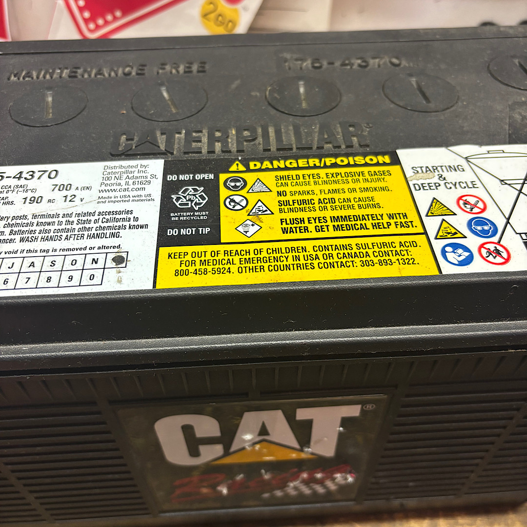

    on another note ... these say maintenance free, but have removeable cell caps.... ever need to top these up?
