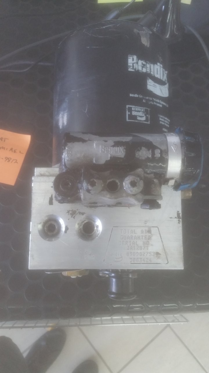

    If you have lines for primary and secondary off the dryer, there is no wet tank. SMH, what the heck is Freightliner thinking on that one?

    Well. The Dryer is supposed to pass gas (Moisture) now and then. IF it aint fartin it aint working me thinks.
    So it's the valve. Cool.

    New air dryer arrived. Installing now and test the system soon. Real friendly and helpful staff here. I told the manager I was posting about them here. He remembered my brother. He is going to discount the air dryer.
    It's called Western Auto, but you walk in and see brake cans, drums, and truck parts. Lots of local truckers get their work done here. You can walk into the shop and talk directly with the mechanic and see your work being done.

    Test drive and everything is 5 by 5. No loads headed anywhere toward OKC, deadheading.

    Back in Oklahoma, waiting to meet my brother for some brisket at the first travel stop on the OK turnpike. Now when I hear the cutout spit at 125 psi it sounds like a polite little dainty fart instead of the "oops-I-gotta-clean-myself" shart.
    Items dependent on air supply work properly. The high/low range selector works and the air conditioning finally stays on the selected fan speed and temperature (a first for me in over a year in this truck).
