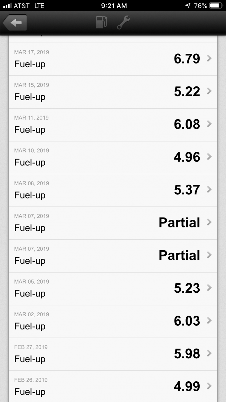

    I have already recouped my costs just in fuel savings. These are the numbers previous to installing the unit. 700B4261-7C61-4AA6-805F-FAEF129327F8.png

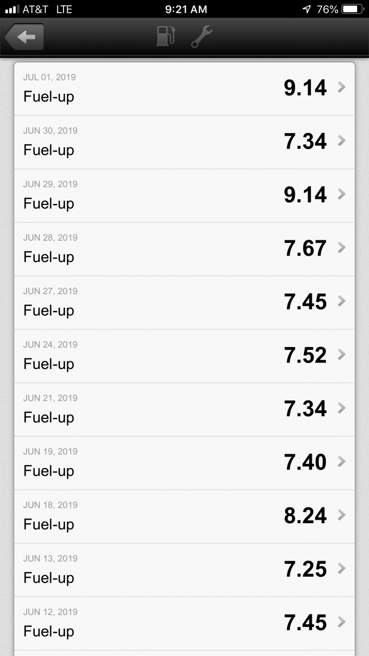

    And these are my current numbers.
