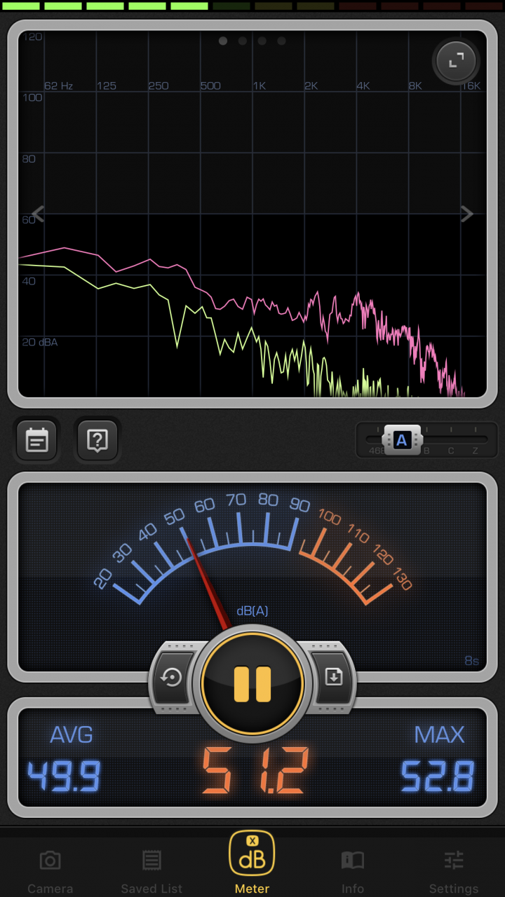

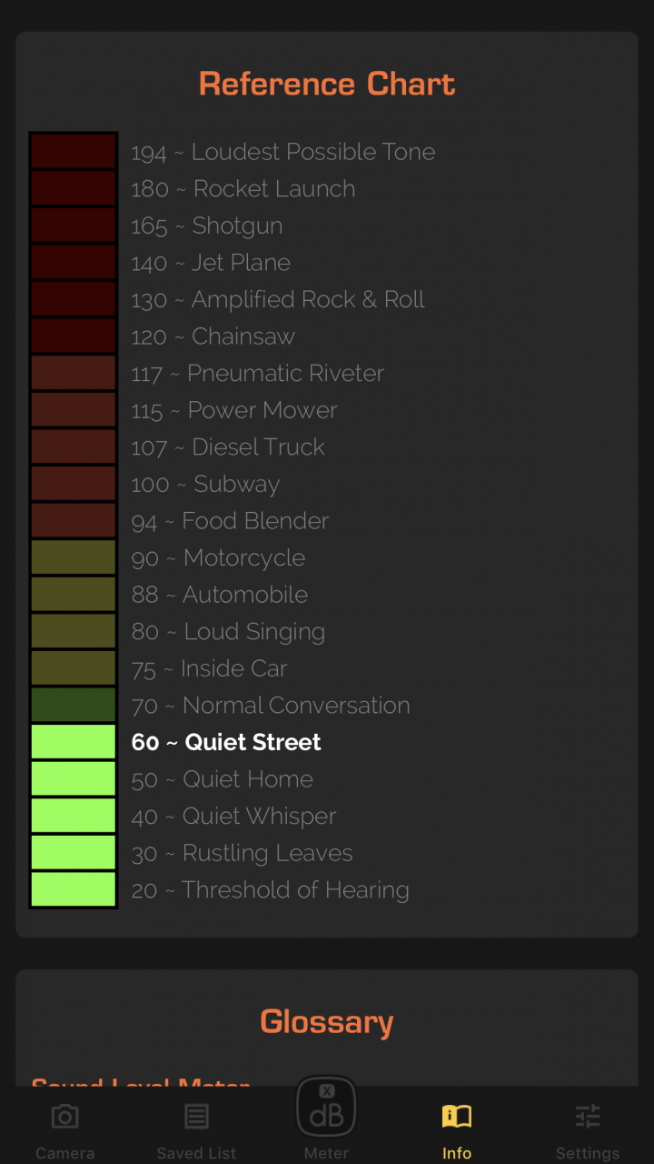

    It is very solidly mounted to the back of the cab. The lines run though rubber grommets and have no movement whatsoever. The evaporator is directly on the other side with 12" of line between the two.
    There are no "huge holes" in the back of the cab. The holes for the lines are drilled, with the largest being 1/2". All could be covered with body grommets if the unit were removed.
    As for the noise, the inverter generator is quieter than a TK APU, especially with the exhaust piped above the cab. I'm sitting here parked on the street right now. I can barely hear the thing running.
    4202D602-B20A-49C2-A1B3-C19C0051068C.png E18A45D5-F181-4A49-9731-513EFB665298.png
    As to your last point, yes, I did think about others when I designed this system. You just assumed I didn't.
