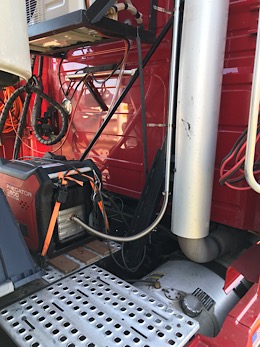

    52767ABD-14AF-4425-B409-4FBEF8960395.jpeg this was my set up. i boxed in the back. used 12v fans i bought at northern tool. used idle air window adapter

    Where did you get the mounting bracket for the condenser unit? I'm going to be buying a WEN 3800 watt generator and a side mount box for.. were there any adapters used to wire the AC to the generator? I'm going to be spending my Easter weekend working on a setup like that.

    I fabricated the mounting bracket myself out of 2 inch angle iron. If you're putting it on a Volvo, you need to tilt the flat part back about 6°, it isn't an exact right angle... 96° obtuse so the condenser sits level. The condenser unit is just plugged into the generator with a piece of extension cord. I chopped it off and wired it to the condensing unit and then just plug it into the generator. There is a separate cable that goes from the inside evaporator to the outside condenser.
