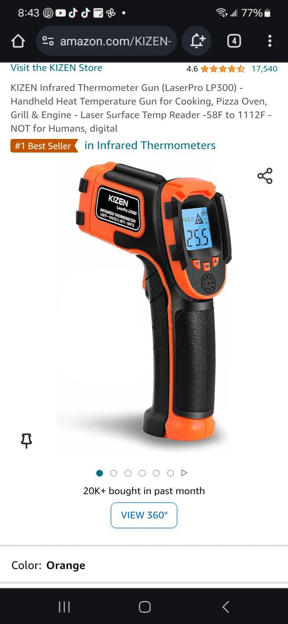

    how does a dyno Not help diagnose 3 dead cylinders?
    This simple and cheap tool could have given you the answer an about 6 seconds.
    check the temp on the exhaust manifold at each exhaust port.
    Feedman, Freddy57, Oxbow and 4 others Thank this.

  5. snowwy
    snowwy Road Train Member
    20,612
    13,333
    Jul 6, 2009
    Stop at harbor freight and pick up a temperature gun. And measure the exhaust manifold temperature.
    You might be able to find one that can park a truck somewhere close.
