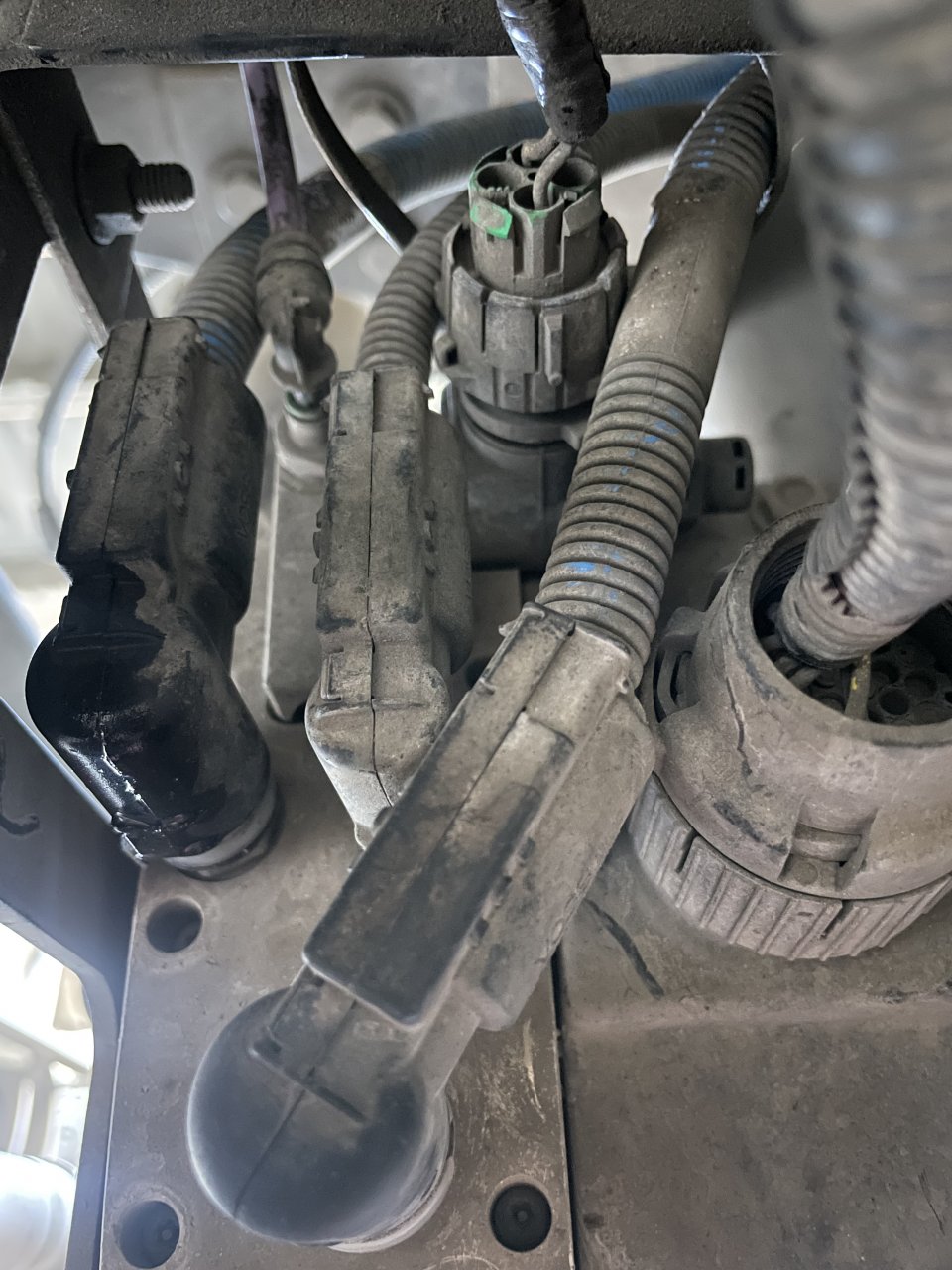

    C55F3436-737D-4130-B58C-D31141402F1F.jpeg Hi guys, I have a 2022 International LT, Isx 15, not using Def since last trip and getting a derate. 3738 and 3548 fault codes active. No air or def getting to nozzle on air solenoid test and pump override test. Can hear the click on solenoid test and air pressure is getting to the big squared module behind def tank (where all hoses meet). Small leak on one of the hoses. Clogged line probably? Don’t know where to start.

    Start with "warranty". If you start mucking about its probably going to bite you.

    Fwiw..If you open the DEF filler cap and you hear a vacuum sound it’s a clogged vent and will give a derate warning.
    Been having this issue with my new truck…vent keeps clogging.
