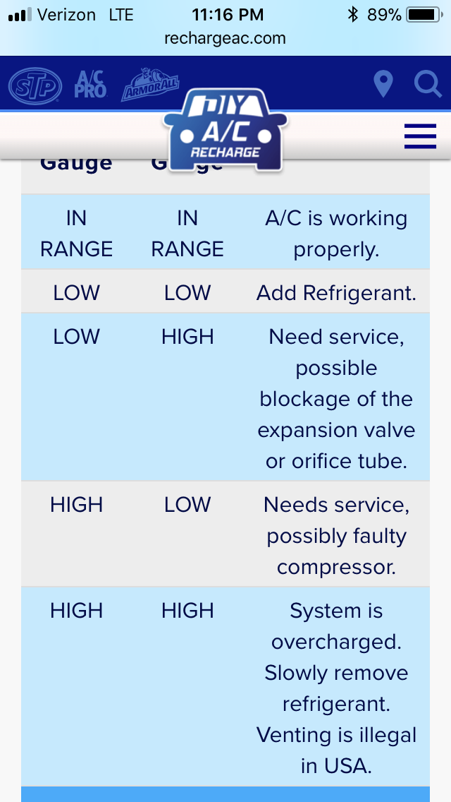

    put gauges on it. then go by the chart. never put any dye or stop leak in a ac system. the best set up for ac systems is the oil and freon.
