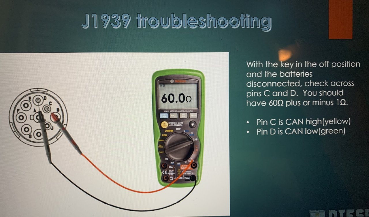

    With a J1939 code and a no start i would say start at trouble shooting the j1939 network,With the key in the off position and the batteries disconnected,check across pins C and D,you should have 60 ohms or close to it
    pin C is Can hi
    pin D is Can low on your network
    if you have 120 ohms one of your resistors has gone bad

    Where are pins C and D? Sorry if thats a dumb question. I can't find that in the owners manual. Im a farmer not a truck mechanic so it's a little out of my expertise.

    no worries,give me a second ill send you a image to help you with locating

  10. biopure22
    biopure22 Light Load Member
    87
    51
    Aug 22, 2021
