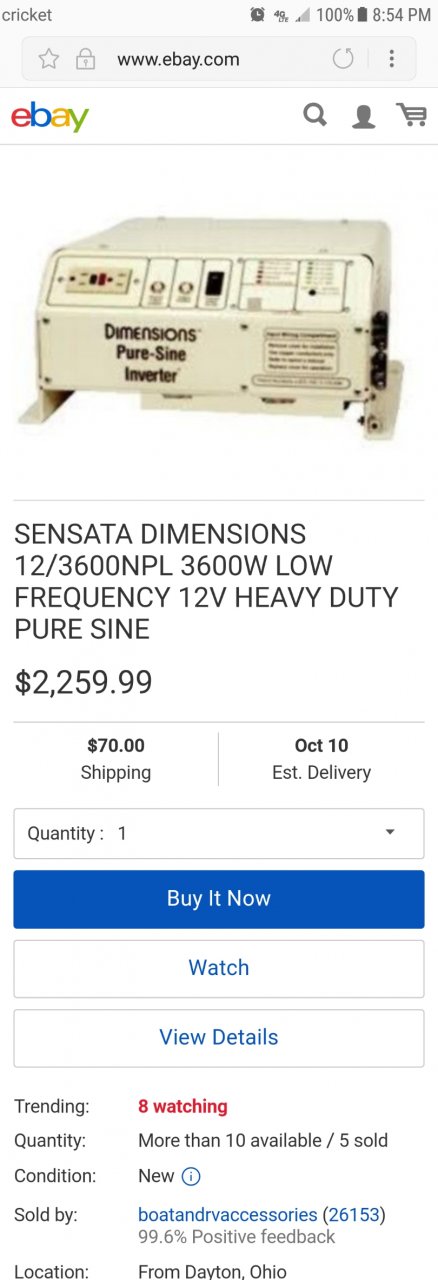

    This would solve your problem quite nicely.
    That's the brand I use and I don't have problems with mine

    If you need 1000w continuous at 120 AC volts, you are going to be putting a hardcore drain on those truck batteries. To get that kind of power out of the inverter, you're going to have to feed it around 85 amps at 12 DC volts. That's a lot of power. Probably upwards of 60-75% of what an average alternator puts out.

    How much to install it?
    Because unless you know exactly what you are doing, you need a professional to do it correctly.
    It would be bad to die by fire because you hacked it in.

    I use appliances (a toaster oven and a grill) that draw nearly 1,000W with the 1,800W inverter in my truck.
    It has a voltage meter so I can see what is available.
    Not a problem with the truck idling, it stays fairly steady.
    It is not continuous once they heat up, but the voltage does not fluctuate more than .1V with the 'on' cycles.
    Running a powerful desktop computer with a large power supply in gaming mode for hours might be different.
    At an idle the alternator is not generating as much current, so you might be pushing the limits.
