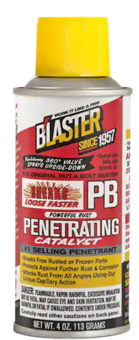

  9. RocketyMan
    RocketyMan Medium Load Member
    554
    337
    Jun 5, 2015
    If it is emissions related, then it is typically 5 years. So as a MY16 vehicle, just missed it.
    If taking off the old sensor, I would BLAST that thing with PB Blaster, too. I've seen horror stories where these things ended up welding/rusting itself to the 1-box.
    QUALITYTRUCK Thanks this.

    I'm letting it soak in wd40 for now. Don't know what pb blaster is.
    RocketyMan Thanks this.
  11. RocketyMan
    554
    337
    Jun 5, 2015
    PB Blaster is just a very nice penetrant oil that I've seem to have fairly good luck with these sorts of jobs. But you're soaking it in WD40. So that should help, too.
