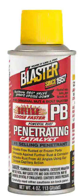

    That can looks like it was designed by a very excited 13 year old

    Hahaha...yes it does!

    PB Blaster is not the best one now for penetrating. Torq CB from Kimball Midwest is the best one.

    WD-40 and the breaker bar worked just fine for me. It was close there for a second, I was starting to worry it was stripping.. but it came out just fine and screwed right back in.
