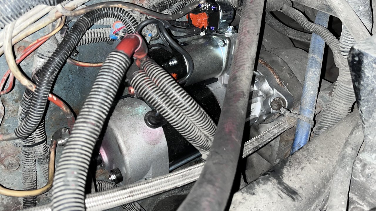

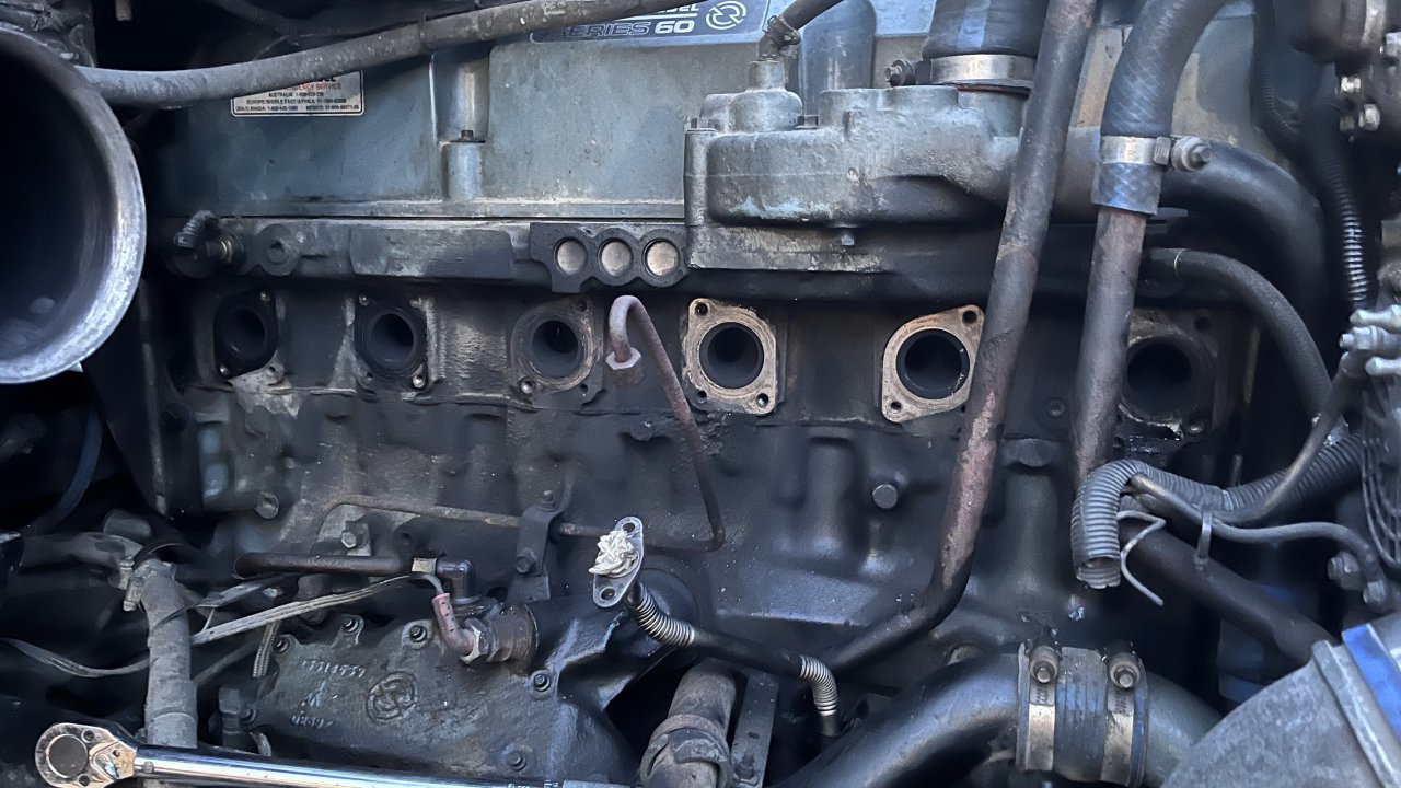

  6. Jed2009
    Jed2009 Light Load Member
    195
    573
    Jan 8, 2020
    Midwest
    IMG_9881.jpeg IMG_0264.jpeg IMG_0265.jpeg IMG_0507.jpeg IMG_0760.jpeg IMG_0762.jpeg IMG_0764.jpeg IMG_0794.jpeg IMG_0923.jpeg IMG_1031.jpeg
    Some fun pics of repairs over the last few months...
    - New starter put in
    - Bolt punctured trailer tire - bought patch supplies and patched it up
    - Snapped off an air fitting in my ABS module - bought a nipple extractor and thankfully got it out
    - New brackets for the old bumper
    - Swapped out leaky manifold for Full Tilt
    - Axle flange seal replaced
    - New steers on
    - Fuel line leaking air, had to get custom one made from local supply shop, and barely got it swapped (one of the mounts was behind the head)

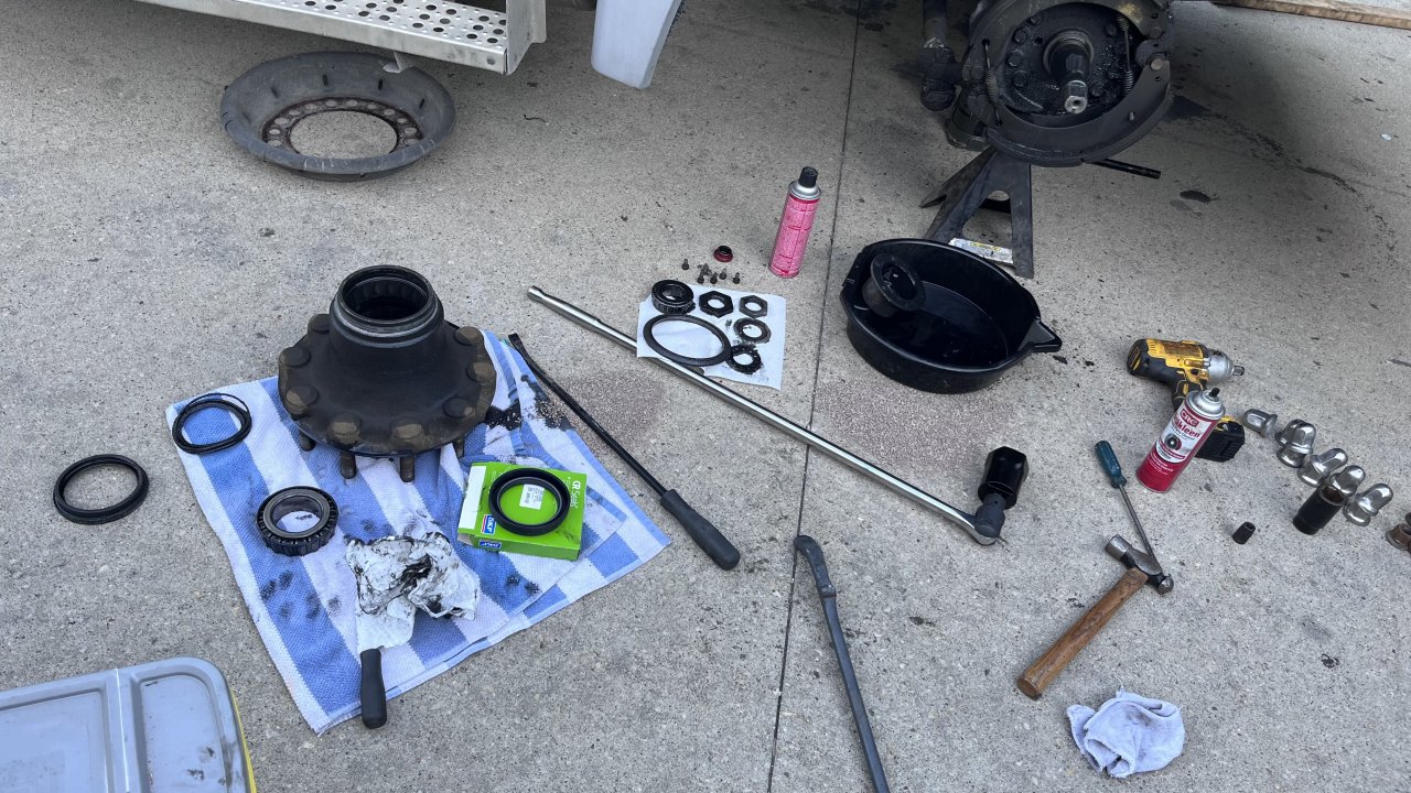

    Tonight’s festivities. Go to check on the truck after sittin for several days and notice a puddle on the steer drum. Blown wheel seal. I’ve wanted an excuse to try out wheel bearings and inner seals so this worked out. Ended up doing the inner seal and outer bearing and race. Inner bearing was like new. Took about 5 hours altogether. Thanks to a few YT videos. Hope it works!
