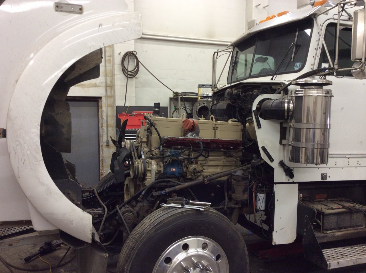

    I have a 855 Big Cam dressed with a N14 Air to Air setup in my 1995 W900. The problem you may have is, having room in front of the radiator for the CAC to mount and clear.

    This is my W900L, the air to air was on it when I bought it. As I said earlier, the clearance in front of the radiator would be your larger problem if any. I changed this one from low flow to high flow cooling, engine is a 1987 model in a 1995 truck.
