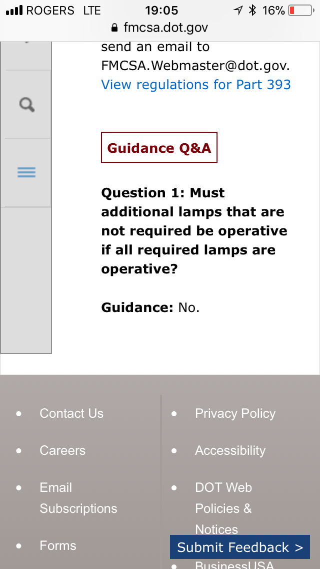

  6. spyder7723
    spyder7723 Road Train Member
    15,471
    25,078
    Mar 31, 2013
    sarasota, fl
    That is no longer the case. Several years ago they changed the reg. Look it up and you will see it specifically states that any extra lights not working is not a violation.

  8. spyder7723
    15,471
    25,078
    Mar 31, 2013
    sarasota, fl
    I keep mine wirking. All 80+ of them. However if one goes out I'm not going to stop everything to try to fix it asap and cost myself the ability to load that day. If a dot officer said anything about it i would open up the green book and flip to the page showing it. I taped tabs to a few pages for fast easy lookup for these kind of things. Straps outside the rub rail is another one i tabbed.
