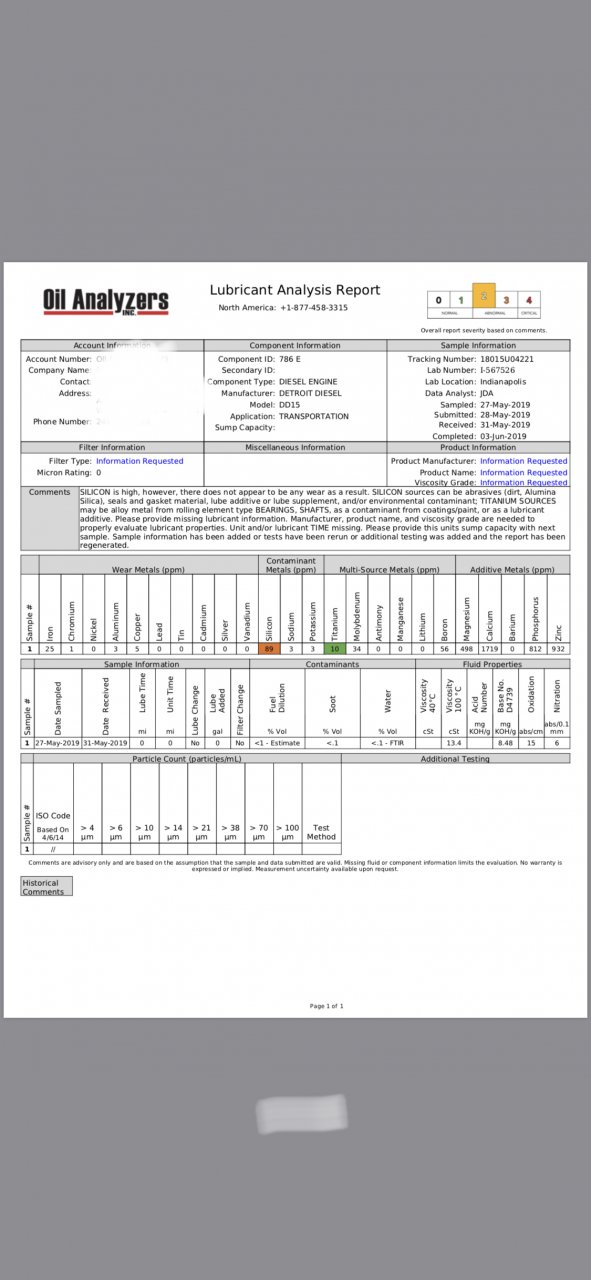

    Silicon and titanium is high. Any suggestions please
  9. Johny41
    Johny41 Road Train Member
    1,192
    1,020
    Feb 10, 2011
    Ontario, Canada
    High silicone could come from silicone based sealat, if you got some repairs done recently on engine components coming in contact with oil.
  10. Newbieboy
    Newbieboy Light Load Member
    91
    25
    Apr 3, 2019
    Should i worry? I just bought truck and I haven’t done anything on the engine maybe old owner did.
