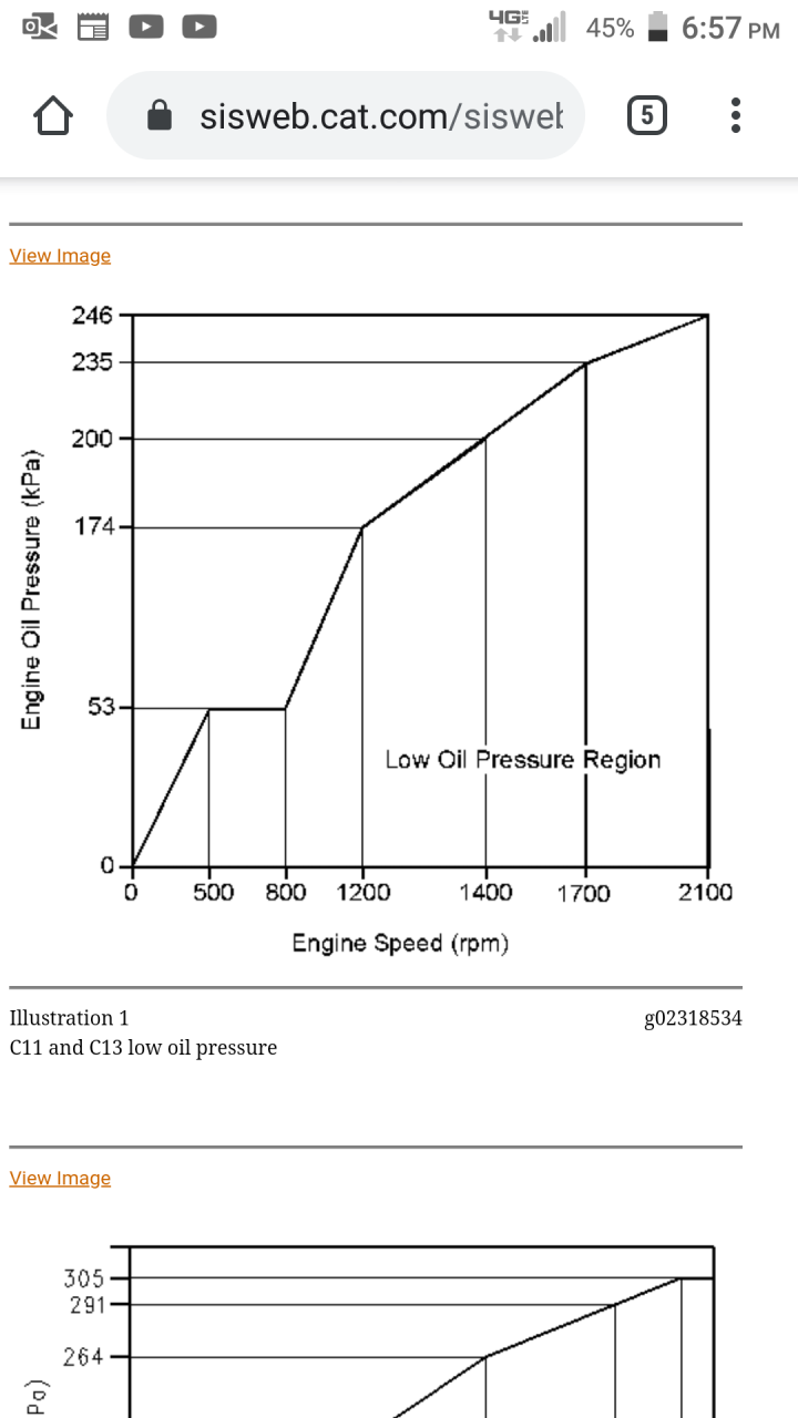

  10. spsauerland
    spsauerland Road Train Member
    4,296
    10,891
    May 31, 2010
    West Harrison, In
    That is normal. Here is chart, have to convert from kPa to psi Screenshot_20200304-185732.png

  11. Perez700r
    Perez700r Bobtail Member
    34
    8
    Feb 25, 2020
    Oil psi looks good across the rpm and I never get a sudden psi drop on the gauge when the oil light turns on.
