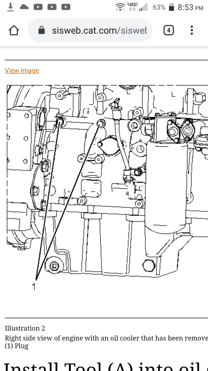

    If you look @ the chart and look at your pressure on scan tool, you have low oil pressure.

    Check from here with an accurate gauge and hose assembly.

    That isn’t on a c13 is it? Where would be the heat spot to check on a c13

    The pic is a C-12, from the C13 manual though and location the same! Your existing gauge hose is probably in one of the oil gallery plugs.

    Ok you wouldn’t happen to know the exact adapter I would need to thread in there?

    The plugs are -6 SAE STOR, some also call it ORB. Any hydraulic place should have what you need.
