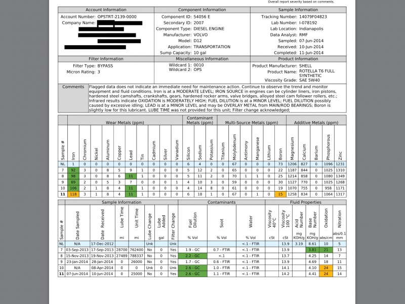

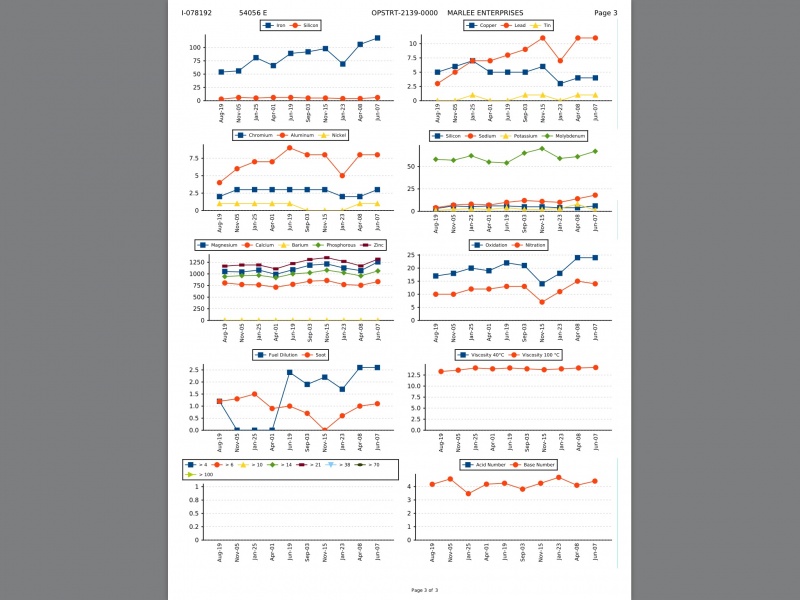

    The oil in the engine has about 250,000 miles on it, i'm wondering how is the oil doing, since I'm not very good at reading this stuff, I change the OPE filter every 25,000 miles and change Volvo engine filters every 50,000. My question should I change the oil ? Keep it ? How's dose the oil sample look?
    Any help will be appreciated

    I'd drop the oil out personally and change it out. PM's are different for every manufacture personally IMHO 25K on a service is way to long. I drop the oil and filters out of mine every 12K it's cheap costs less than $150 for 10 gallons of delvac and Baldwin fuel and oil filters. Your iron is elevated, not high but elevated something to keep an eye on, same way with your boron. Keep an eye on it at 250k the levels aren't the worst I've seen, but I've got a motor with 1.4 on the clock that is showing less wear. I'd cut the service intervals down a little bit and change it out a little more. Oil breaks down over time, it's cheaper than putting fuel in, and it's a lot cheaper than changing engine parts.

    I have a bypass oil system on my truck OPE unit I change the OPE oil filter every 25,000 miles and take an oil sample at that time, the next 25,000 mile I change all the oil filter including the three on the truck plus the OPE filter. At that time the engine is getting about three gallons of new oil.
    Am asking how the oil doing in the engine, are the levels getting too high like ( iron, Copper, aluminium, sodium, ete. )
    Any help would be appreciated reading these numbers.

    With 250,000 miles on the oil I suppose it looks good. But the way I see it iron is high, sodium is high, boron is low, fuel dilution is high, TBN is border line. We all have our own way of doing things. If you are comfortable with it, its good. I would not be comfortable with it.

    I was getting a little concern about all the iron and sodium also, I think in 12,000 miles I will drain and replace all the filter and start fresh again.
