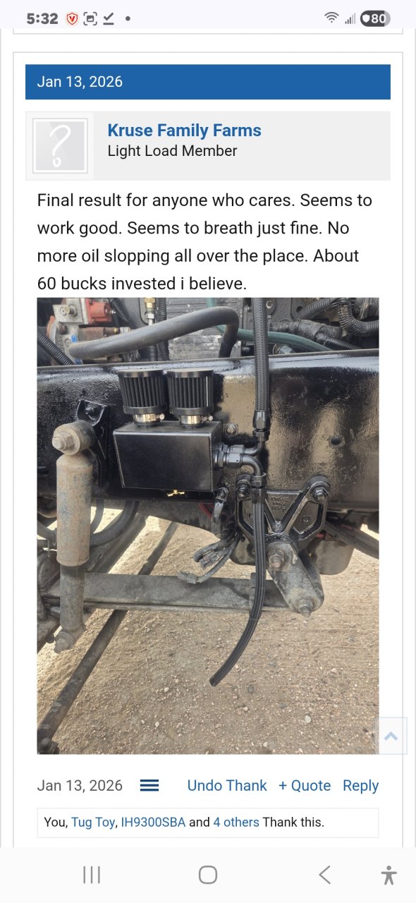

    Don't know if I would put one on a truck that runs in colder climates. Probably freeze up and blow out dipsticks and crank seals unless you mounted it somewhere warm under the hood. See it all the time on stationary equipment where that stupid little crankcase breather filter ices up solid.

    5
    7
    Jun 10, 2014
    How big are the ports for the filter? If I were to install this, I'd need to be running dual lines in with how small the 10an fittings are. Does it seem like the filters would be too restrictive to actually use?
