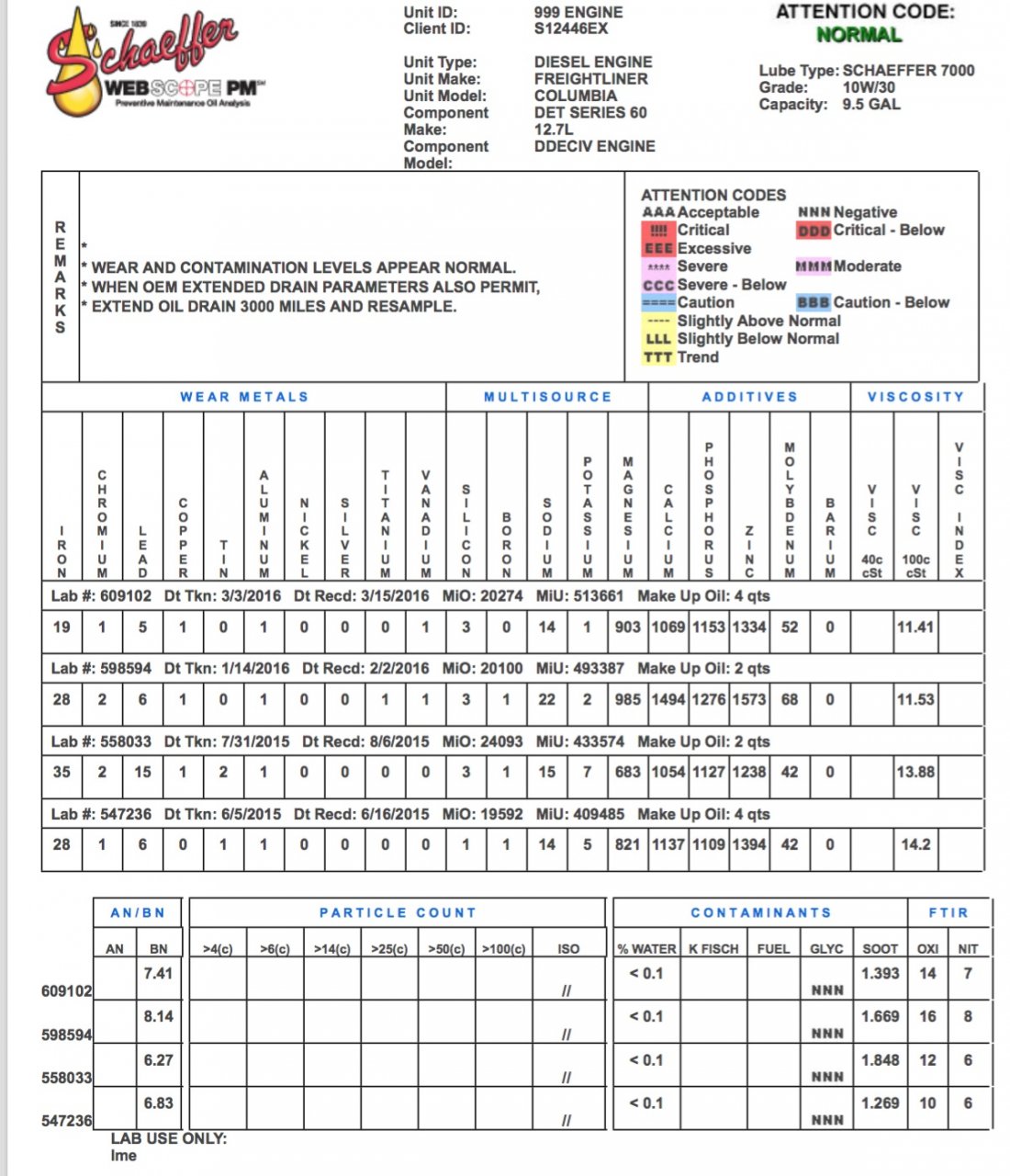

    Here is a group of samples from my factory remanned S60 with over 500,000 miles on it. The samples vertically (latest sample on top), the first two show results from using 10w30 the second two from using 15w40. The 10w30 is doing quite nicely, is holding TBN and viscosity better, and the latest sample shows lowest wear numbers. Not bad for a factory remanned motor with over 500,000 miles on it.
