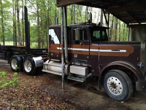

    Lol, I know I'm the ####### outlaw amongst my trucker friends. EVERYBODY has Pete's or KW's (mostly in the shop) lol, jk. I just love me some shakers. Started out when I was 16 driving a '75 WFC. I just can't get behind the cab layouts in the Paccar trucks. Although I do rank them second, still ahead of Volvos, Macks and Sterlings, lol.
    Something like this with an 855 would be my ideal starting point.
    http://montgomery.craigslist.org/cto/4449167468.html
