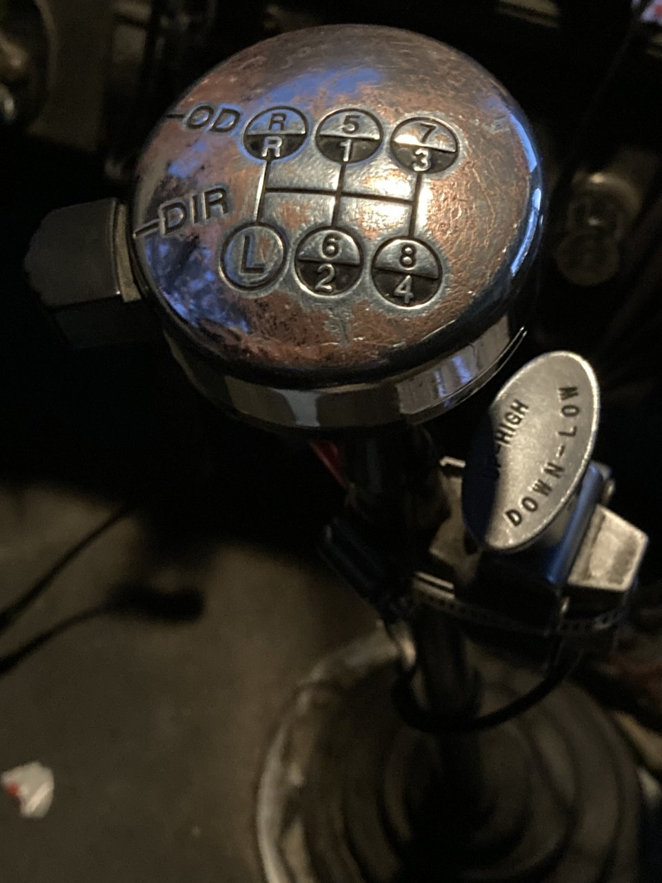

    I just added a high low valve. I had to split the red supply line and run one to the knob and one to the valve.

    That’s the way I’d like to set up my 15 O.D. . I’m guessing it’d work? Range on the side of the knob and deep reduction is the add on button? Of coarse my knob would have to be for a 10 speed and they do make them. Looks like you got a 13.

  7. Jubal Early Times
    3,069
    20,586
    Oct 17, 2022
    It’s an 18. Range is the up down and splitter is the side.
    Bean Jr. and mile marker 27 Thank this.
  8. mile marker 27
    mile marker 27 Road Train Member
    1,419
    1,739
    Dec 4, 2019
    Gotcha. The original shifter(9 speed) labeling just isn’t as you’re using it. Button on the side was originally the range but now you’re using to split. So, back to my original post. It can be done but not with an old style 13 speed knob. Has to be an old 9, with add on button. Thanks, man.

  9. mile marker 27
    1,419
    1,739
    Dec 4, 2019
    I’m gonna get around and do my 15 like that. Get an old style 10 knob, use the side for either deep reduction and an add on button for range. Guess I could do it vice versa, as well.
