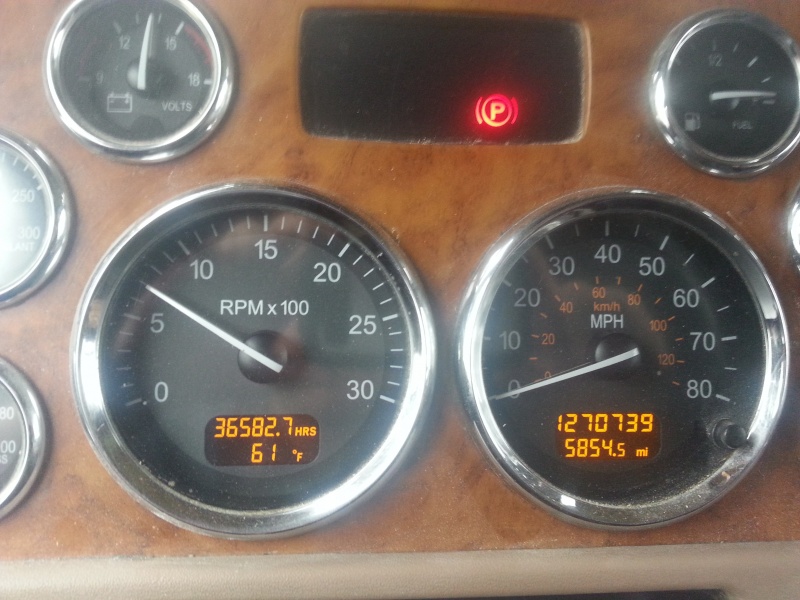

    This is the hours you get with a truck w/o a APU
    07 Pete 386
