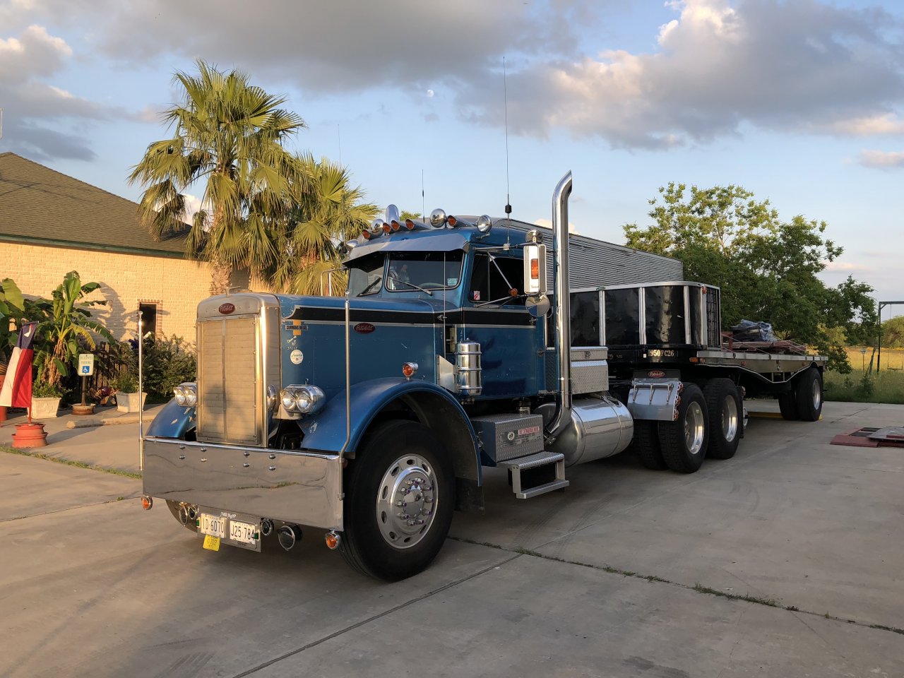

    25BB88B9-6020-46C1-9023-5518746D4332.jpeg I’ve got this combo registered for 26,000 gross and antique in Texas. No cdl required.
