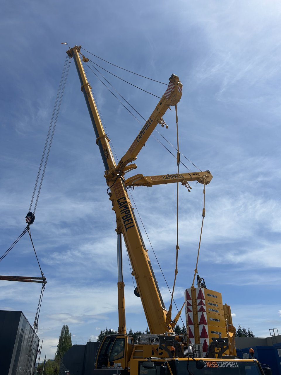

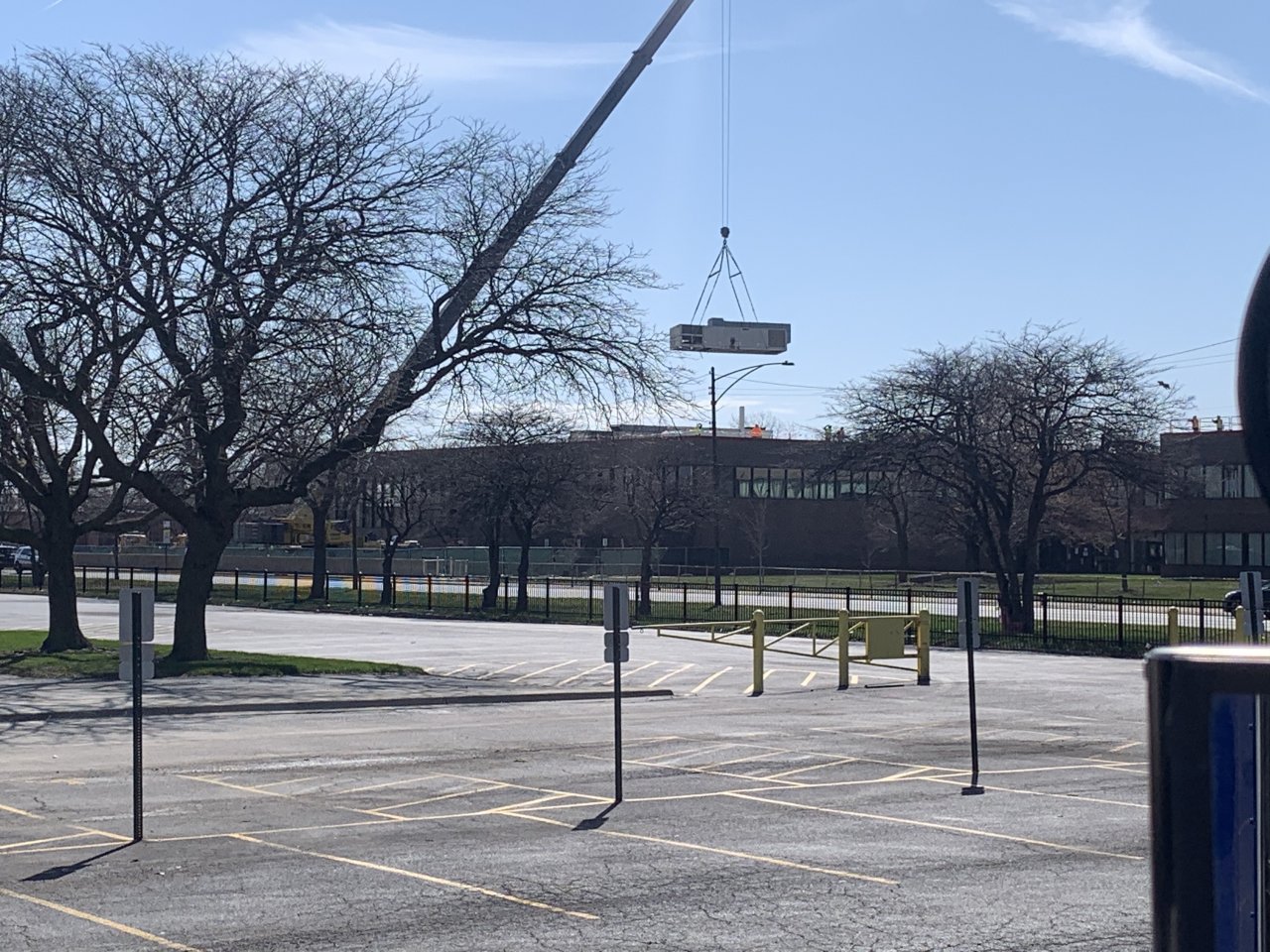

    This right here. The pictures are what they used, but the larger crane is to finish. Definitely need an oversized crane for long spans. The longer the lever the more the leverage. If you need to place something a ways away it gets a bit bonkers the size you need.

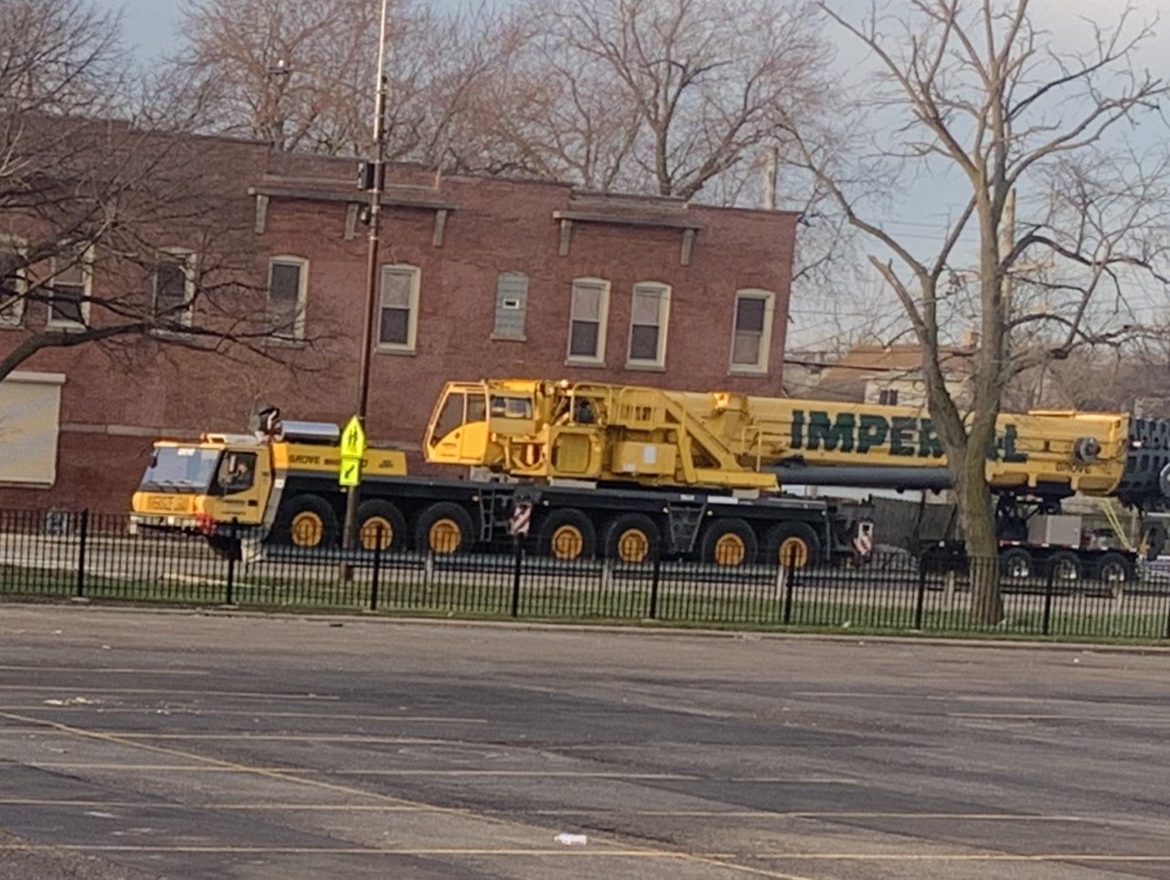

    here is a 500 ton crane - just under it on Monday

    We used a 60 ton a few years ago to set rooftop AC units .
    it will lift 60 tons right next to the crane .
    But stretch it out to maximum reach and it will only lift 2 tons .
    we had a small boiler that weighed 3 tons and it wouldn’t lift it , we had to break the boiler down into two sections .
