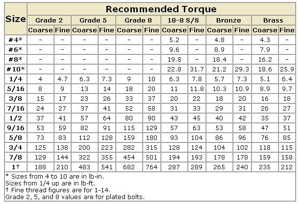

    Outer wheel seal axle nuts, looking for torque spec (front drive axle)
    Truck has 7 of the 8 nuts loose with my fingers and was leaking hub oil. Whats the torque spec on those, i can find hub torque and lug nut torque spec everywhere, i just cant find the axle nut specs anywhere (i also might not have nomenclature correct)

    This is for the bolt shaft size and it is a good guide
    skallagrime and tommymonza Thank this.

    Yeah, that would be ideal, but its completely worn away. That second one is the ticket.
    150-190.
    And yeah, seems my nomenclature wasnt getting me quite close enough
    Thanks

    185 ft lbs.
    Replace the locknuts. Nylock are one time use. If the studs come out of the hub, clean and dry, apply red loctite and double nut install them back in the hub.
    Torque in a star pattern just like a wheel.
    Clean and dry gasket, no sealant.

    Certainly go by the stud diameter for the axle, and torque on the high end of range. I am pretty sure they are 10.2 grade steel. I think you were asking about the wheel bearing/hub nut ("axle nut"), assuming you want to torque while the axle is out. I have always used Mike Beckett's ( from MD Alignment) procedure to torquing wheel bearings and never had a problem. MD Alignment: Bearing Adjustments -. This is a link to a video I have had for a decade that explains this procedure. I hope I don't have a problem with copy right infringement.

    Those nuts were what i was asking about, not that specific axle or even this truck but same size.
    Got it done, filled and off to a good wash, we'll see what it looks like in a week
