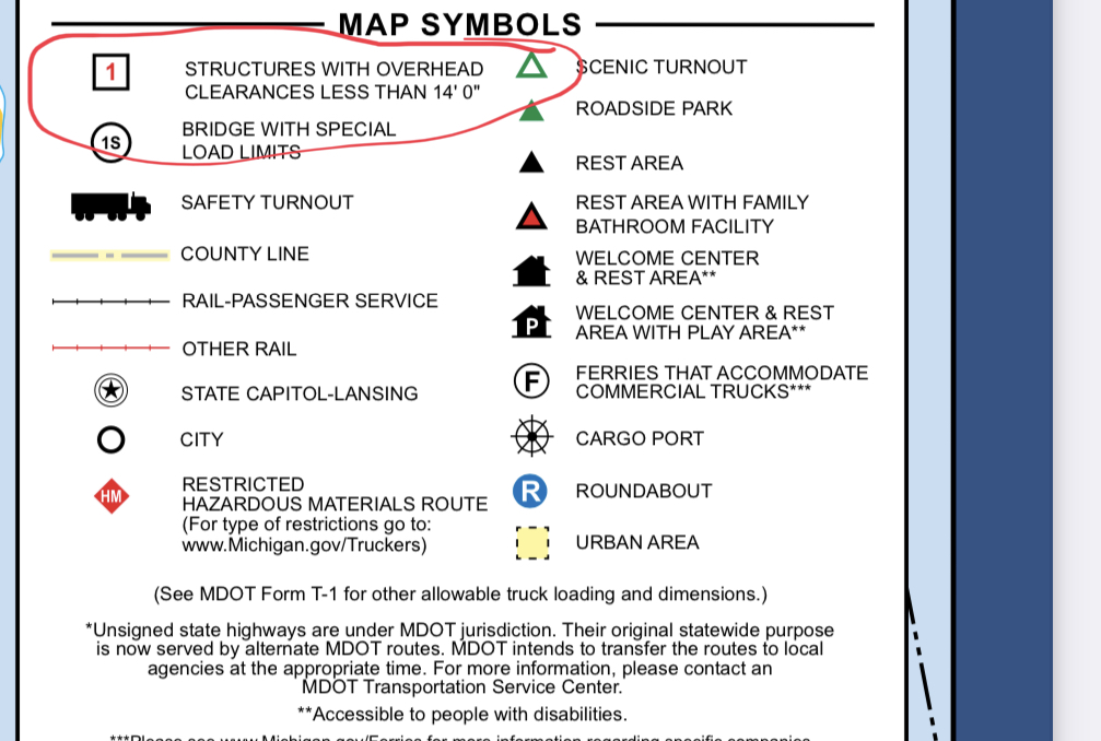

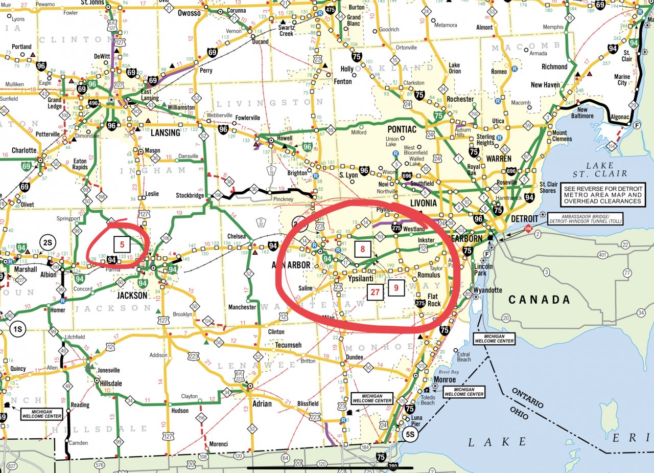

    I mean these types of maps. Maybe not routes as if you were permitted but some restrictions if caught in a pickle. I don’t do the oversized stuff like you do. Nor have tour amount of experience but after reading threads on different roads etc and not always getting the most correct info I just google for whatever state I have a question about. Only reason I am posting Oregon was length issue on a route I was looking at and ended up taking another. Maybe every state doesn’t have them but Michigan does.
    https://www.oregon.gov/odot/Forms/Motcarr/8119.pdf
    This map from Michigan will show anything under 14’ just takes whatever road @God prefers Diesels friend (lol) is going through and look for the red number with a square. Several near Detroit
    https://www.michigan.gov/documents/mdot/2021_Truck_Operators_Map_719781_7.pdf
    B1A28247-A6EE-4857-BCA9-31F5A2F097CC.jpeg 4F5179F5-680C-4004-BD3A-9B88ADD2D56D.jpeg

    @Old Man just to be clear, I posted that info for folks like myself with less experience when the atlas might not show everything and the GPS tries to kill you. This tadpole ain’t trying to teach a bullfrog how to swim lolol
