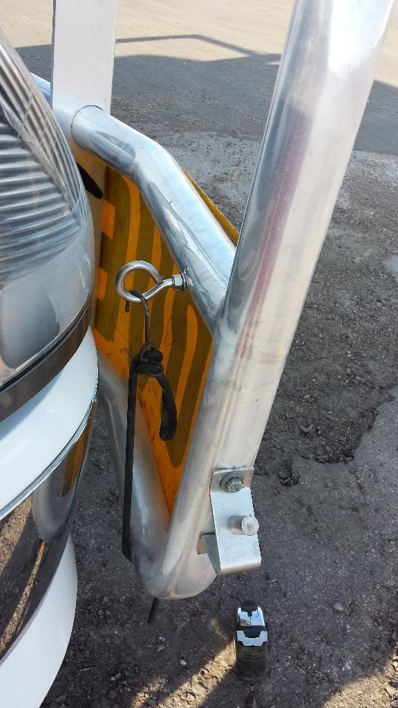

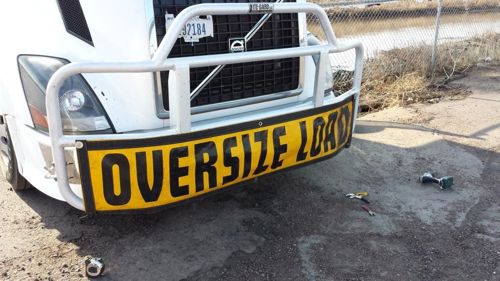

    This is my set up for my signs and flags.
    Cetane+, MJ1657, 281ric and 1 other person Thank this.

    I just had them thrown up there to show. Also #### Texas
