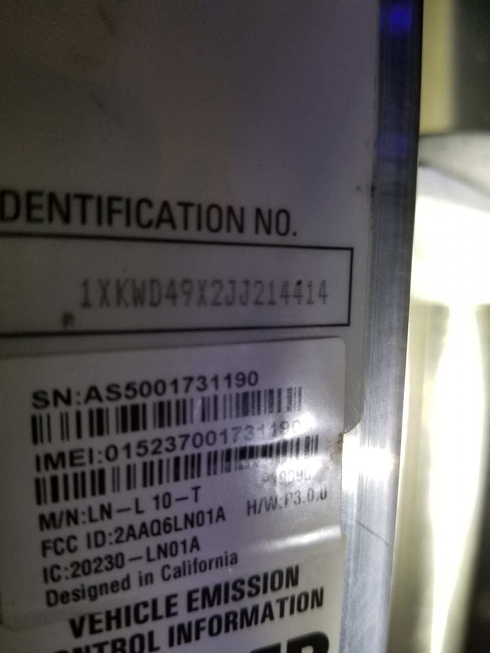

    214414 is an 08 T800 daycab with an ISM and a 10 speed.
    Must be wrong number

    KW is recycling the last 6. Mine matches a 2006 T800 and my 2016 T880.

    I was meaning the serial number of the truck you were buying so I could get you the rear end specs.....
