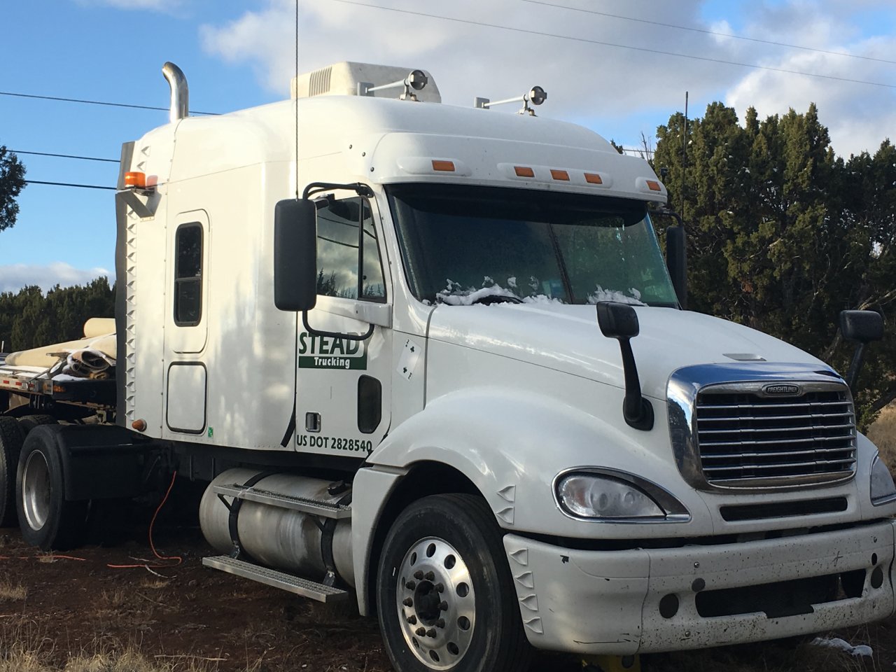

    Mounted on the mirrors would drive me nuts & depending on the width of the load, may not be visible to the rear.
    I have one mounted on either side of the sleeper on the rear fairings, up high enough that they don’t flash in my mirrors. I also have one for the middle of the roof, but have taken it off temporarily while I come up with a better mount for it. Then the trailers have 2 4” round strobes mounted in place of one of the taillights.

    I have led strobe light on front of cab above windshield.
    Two round installed rear of trailer with tail lights.
    I carry 2 magnetic led strobe lights. Put anywhere on load or on trailer. I also have 4 lights magnetic base, similar to Foxfire lights. 2 red lens, 2 yellow lens.
    Trailer also has 4 led Amber led lights that slide out to 16 feet. Switched for full on or flashing. 2 each side.
