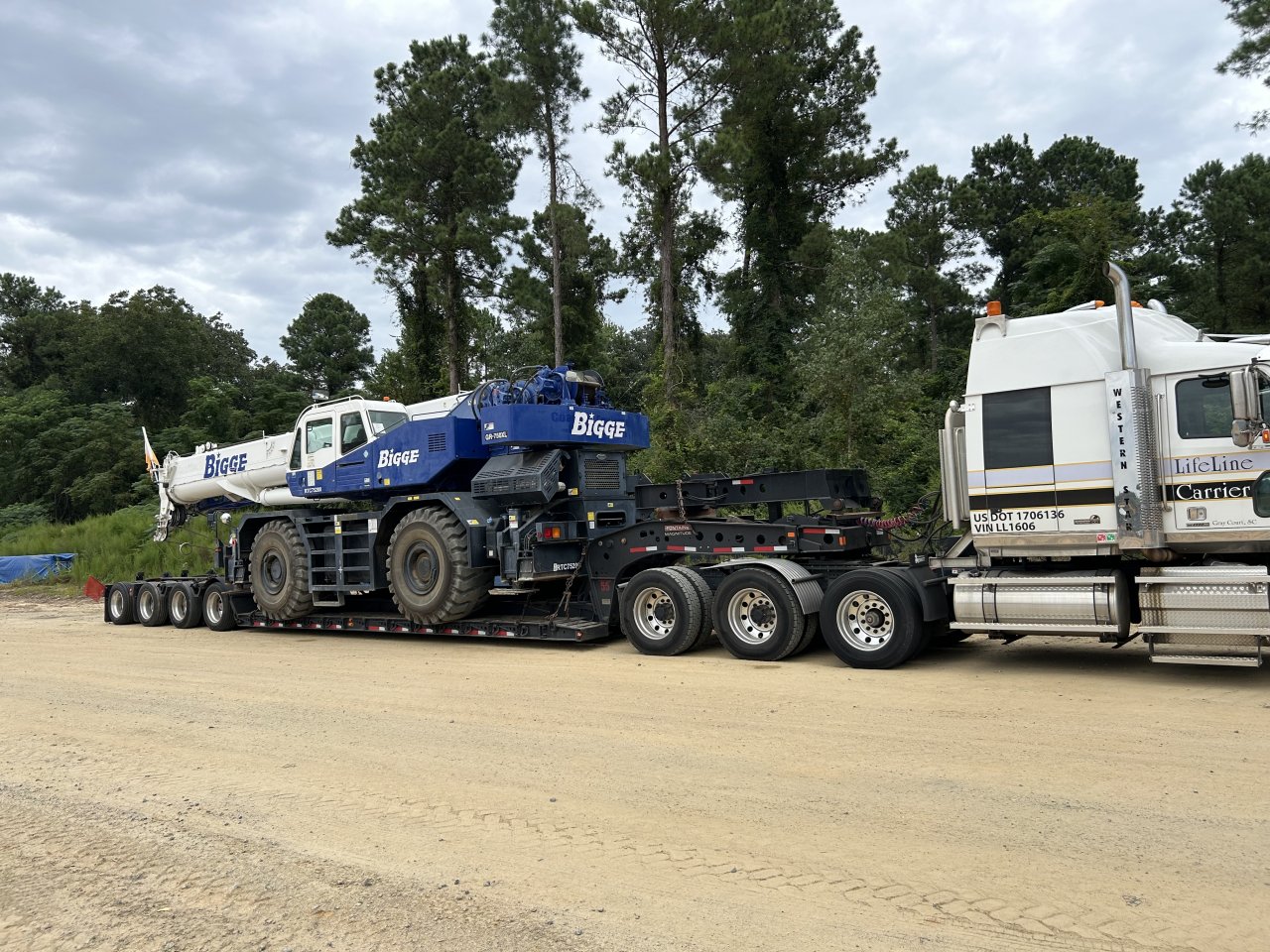

    IMG_3009.jpeg I took the broker to the woodshed and got 5.15 a mile today! #winning
