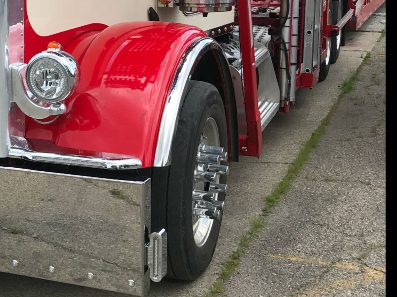

    3245446E-52B7-4AA2-9A10-BB447FD0334C.png If he was that anal to not let you bobtail to get tires I am surprised he let you leave without a heavy rated steer axle. It was my understanding that you have to have both heavier rated tires and heavier rated steer axle. I have a 14,600 front axle and run Michelin 295/70 R 22.5 as I routinely carry 14,600 up front. I put 3.25 offset flat face wheels up front to help with irregular wear. It gives the appearance of a wider tire as the wheels sit further out and could help you BS your way past anal cops like this. For every gallon of fuel I carry 80% of the weight goes on my steers, so carrying less fuel may be your easiest option until you figure it out.

    interesting, i have never seen such wheel before.
    here car carriers are using 315/60 R22.5 on 9.00x22.5 (16500lbs) or lately 355/50 R22.5 on 11.75x22.5 (17600lbs)

    12,350

    But that dosen't change the 12,350 sticker on the door

    I agree with you he was ok with H rated tires I personally think it was a scam the Goodyear tire dealer said they sell a lot of H rated tires.....

    Problem has been averted but not solved
