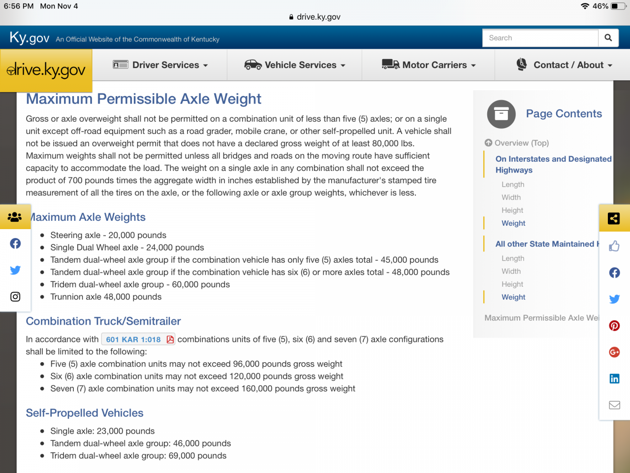

    I cross scales in Ky daily and Indiana often at 14,600. In weighs me every time but after Ky got to know my rig and that I am allowed 14,600 I get the green light on Pre Pass every time.

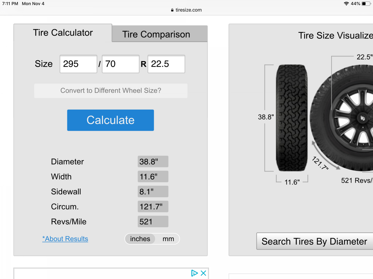

    816810EE-0248-42F3-A195-5B5127181DA2.png 8A64310B-D8C3-48C6-ACDD-5FEC99D248EA.png 6A09BACA-EDC4-4D8D-8CF5-F75012D461EA.png It has a lot to do with the width of your steer tires also.
