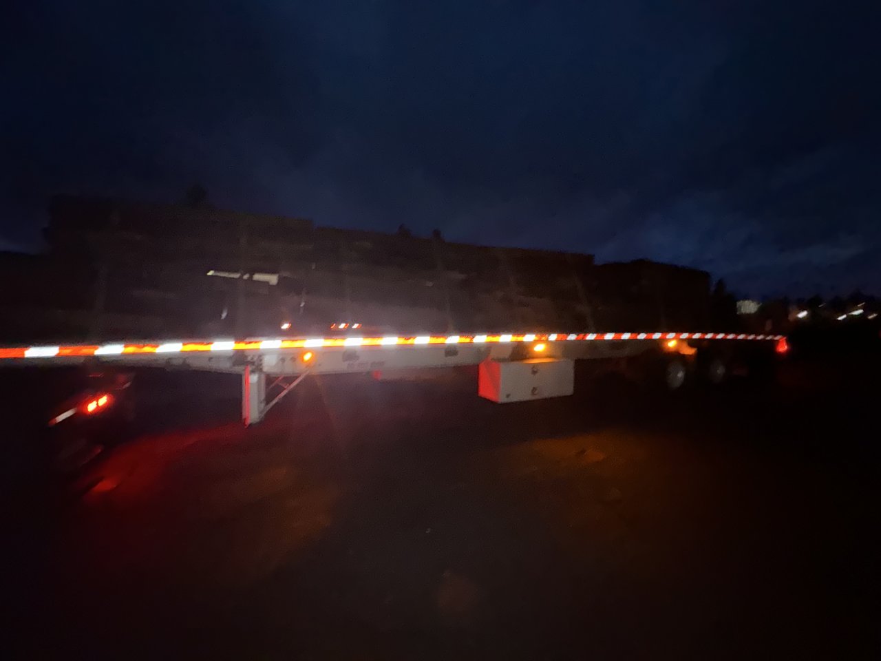

    I have already dropped the load off. Here is a picture that I took this morning but you can’t see much of anything.
    Kyle G. Thanks this.
