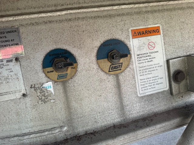

    I do. The valve on the left is in the wrong position. This situation seriously sucks.

    Just pay the fine and move on. You made a mistake with the suspension valves and they caught you before you figured it out. Overweight fines don't count against your license or your company's CSA score. They are just a fine.
    Nebraska got me for 14K over gross a few weeks back because my permit service made a mistake ordering the permit and I didn't catch it. I had plenty of axles for it but it wasn't on the permit. My fault for not reading the permit. $374 fine and $25 for a new permit and off I went.
    I'm not sure how you couldn't feel a trailer with no suspension though. I've had trailers blow air bags or have leveling valves flip and dump the suspension and I can immediately feel it because the trailer will buck hard on any big bumps.
    Consider this a learning experience to do a walk around after loading and kick your air bags to make sure they are actually inflated.

    Thanks for the information. I have done the split axle before. Not all the time but sometimes. Now it will be all the time. I did feel the trailer buck and did wonder what was going on. Not hard but enough to notice a difference. The load was going to Bend, OR

    Glad it was something simple. Did you set the trailer brakes when you stopped on the scale? On some trailers that will automatically deflate the airbags, so that's something to keep in mind to not do in the future.
