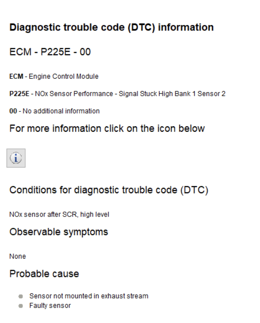

  6. Jooeugen
    Jooeugen Bobtail Member
    29
    3
    Mar 14, 2021
    This code comes and goes in the interval of 1-2days on my vnl volvo 2015. From different online search P225E00 - nox sensor performance - signal stuck high bank 1 sensor 2. Faulty sensor or not installed properly. Worst case ecu problem. Usually faulty sensor .
