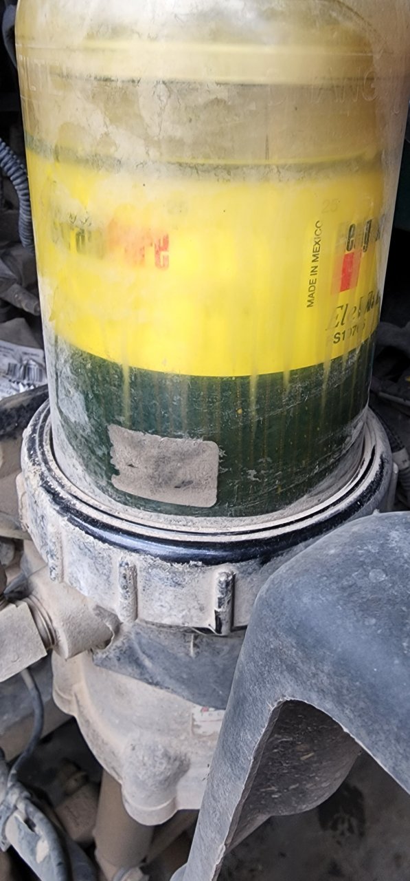

    Absolute crap and bankrupters. Avoid at all costs if you have a shred of sense. More detailed answer. The engines CAN be good. They require strict to the letter on time maintaince to remain in good working order as well as a bunch of extras. And they can get good MPG, they are also light and "cheap" to replace engines. However they have some pretty nasty quirks too. For example they tend to clog fuel filters quite easily.
    This filter has only 4700 miles on it and is already jet black and this is pretty typical even after i had my tanks scrubbed to ensure it wasnt a contamination issue. This is what you get with any amount of bio diesel.
    Next they are VERY costly to maintain and heavily locked down due to davie4 software which makes it hard to find 3rd partys to work on them. Additionally parts can be quite hard to find and even "common" parts can have multi week wait times. Go see my new owner thread sometime for a great list of all the issues buying used paccraps from my PoV as there is so much on that list i dont even know where to begin.

    On an unrelated note, do you use pre filters on your fleet as well like mine or just the inline one to the engine? Mine had massive issues until i added the pre filter as pictured above. This one came without. And even with the pre filter it will go to 10k miles....usually unless i get #1 in which case it desolves. It does always turn jet black by 5kish miles though which is when i swap out of pure paronoia.
