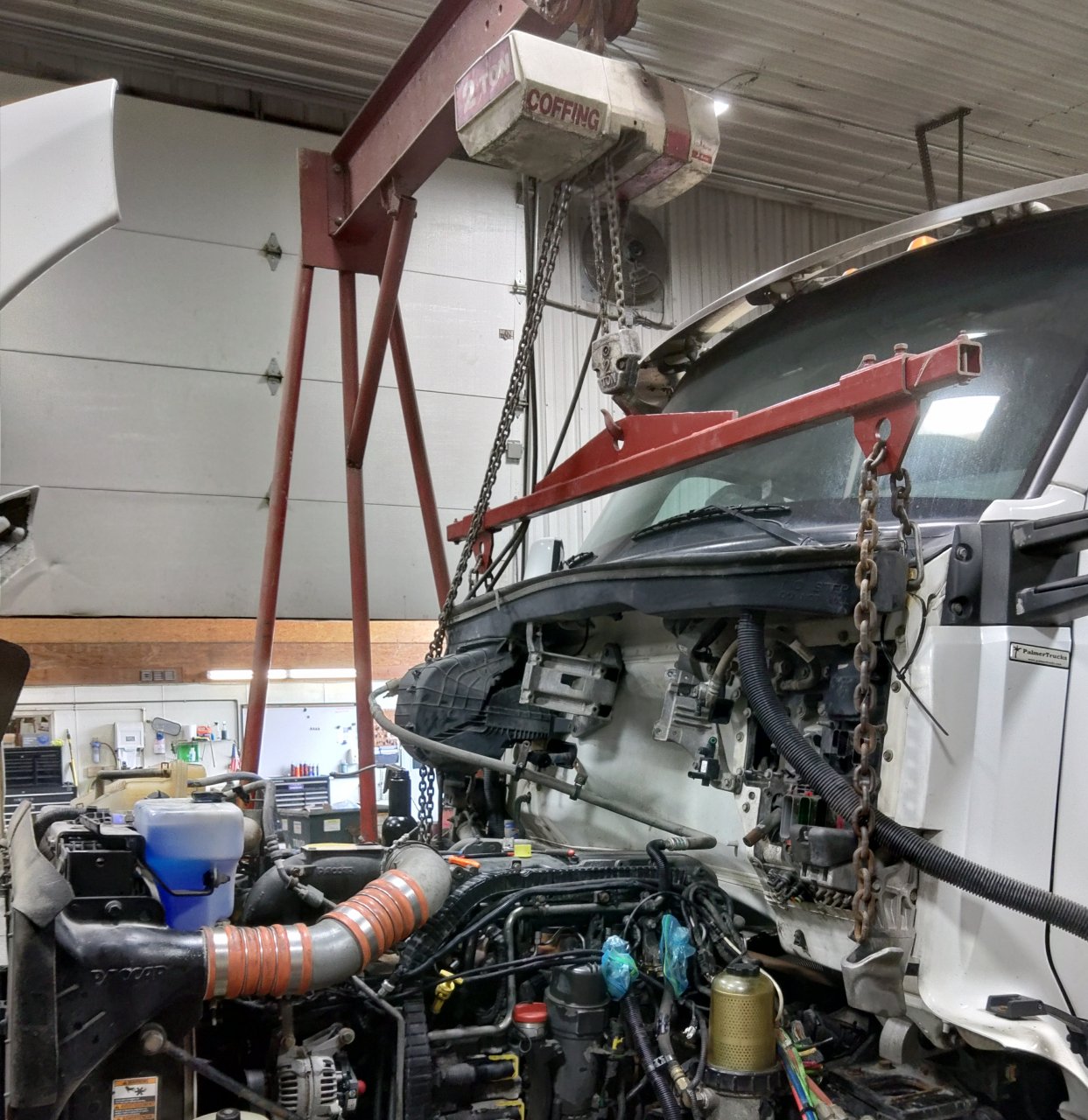

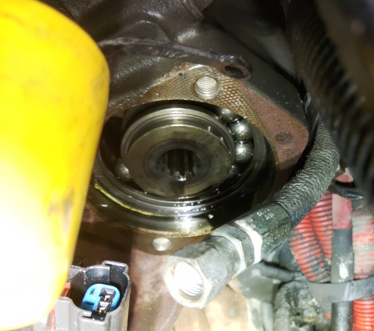

    Another one bites the dust. All 8 ball bearings there, cage not so much. Symptom was making P/S fluid. I lucked out of this one, doing injectors instead. KIMG0071~2.JPG
