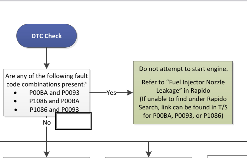

    Hey drivers & diesel mechanics,
    Got a 2016 T660 with 2015 MX13 & these two codes showed up P1086 & P00BA. Now I know it’s fuel pressure related. As per service manual when those two codes come up it says to refer to “Fuel injector nozzle leakage” on Rápido.
    Well I have no clue what rápido is or have access to. I think it’s some kind of software? Who knows, but I was wondering if anyone knows about this. Thanks in advance.

    Rapido is PACCARs online service guide.
