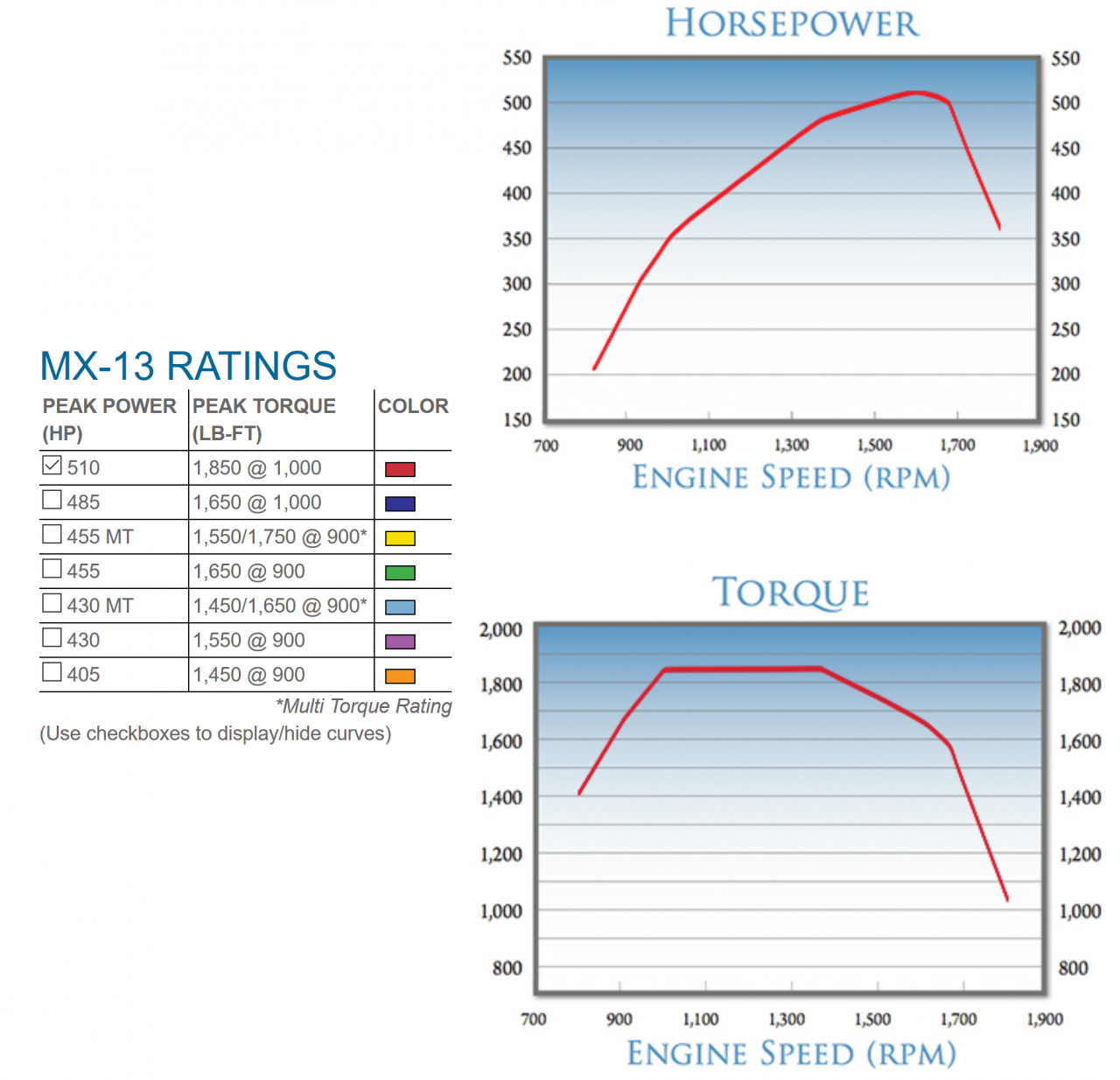

    I have been driving a MX-13 set at 510/1850 with 3.73 rears and 13-speed, pulling a set of B-trains loaded to 137,800 lbs gross. Shifting 1500-1600 rpm, drops to 1100-1200.
    Either you are trying to skip gears, or there is something wrong with the motor. 1500-1600 is the shift point for this motor.
    You are supposed to shift as the horsepower begins to peak, so it drops back into the max torque range to begin pulling in the new gear.
    Ponies aren't what gets the truck up a hill.
