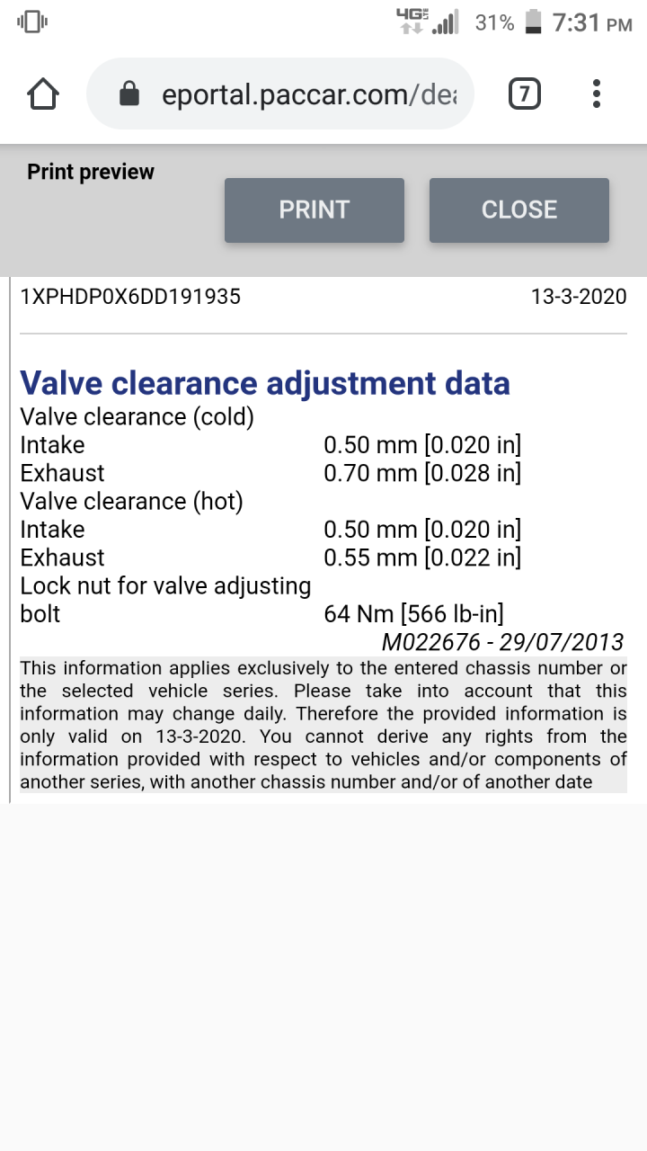

    Have an epa 10 paccar mx 13. Going to adjust valves myself but dealership couldnt or wouldnt give me the clearance settings. Can somebody Help me out with that please. Thanks in advance

    0.020" intake, 0.028" exhaust. 47 ft/lb jam nut torque.

    No reason for me to lie, but screenshot from RMI. I have set a couple overheads on the MX.... Screenshot_20200313-193153.png

    Already had pulled up paccar specs online and was actually double checking with this guy. I agree. But he confirmed what i done seen
